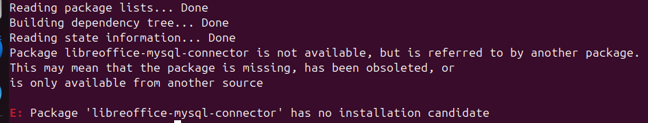

The plug-in libreoffice-mysql-connector was required before, but since LO 6.0, it was embedded in LO package.
I just look now : it is not available since Ubuntu Noble.
But you are right, the good package to install is : libreoffice-sdbc-mysql. I tried just now on a VM with Ubuntu 24.04 and after that, this direct connection is available again !
