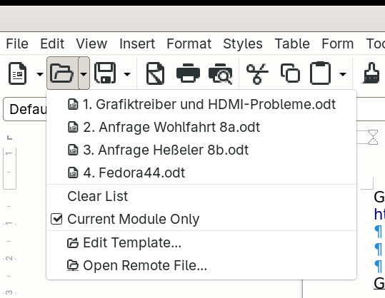

I wonder that Calc and Writer show a different number of recent documents. Calc shows the last 5 documents, Writer the last 8 documents. As far as I remember I was able to adjust this number, possible somewhere in the Tool/Options menu. But I do no longer find an option that I think about.

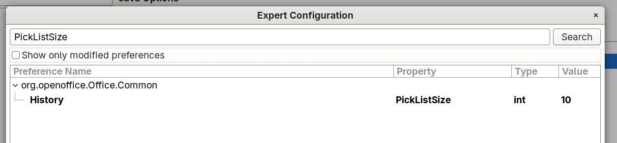

The keyword to search is Picklist:
Thank you for the hint with ‘PickListSize’.
I set this to 10:

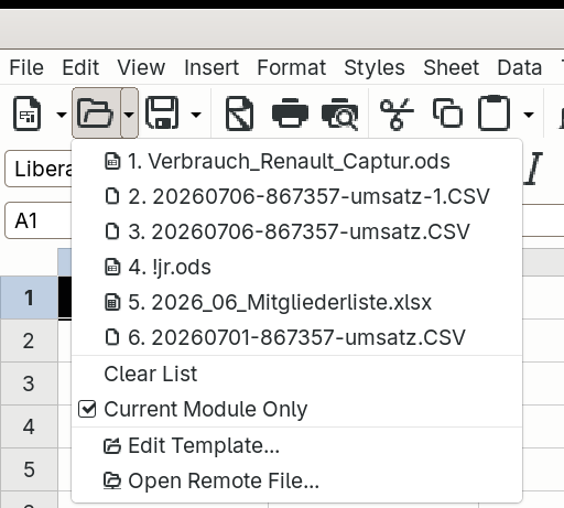

But I still wonder that Calc and Writer show a different number of recently opened docs:

You have the “Current Module Only” option set, so Calc (Writer) only shows documents that are processed by this module.
10 is the size of the complete list, and you have 4 Writer-documents and 6 documents opened with Calc.
