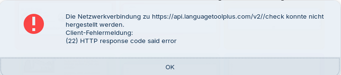

Hi,
I’m a languagetool premium customer and switched it on with the API URL https://api.languagetoolplus.com/v2
I’m using office 26.2.4.2 (X86_64, Linux 7.0, de-DE)
Some time after Writer is open the following message appears
Saying:
The network connection to https://api.languagetoolplus.com/v2//check could not be established.
Error of the client:
(22) HTTP response code said error
My internet is working.

I contacted the Languagetool-Team, but they said it’s a Libreoffice problem.
Thank you for reaching out.
The LibreOffice integration was developed by members of our open-source community, as well as LibreOffice itself. As we only provide the API key for accessing Premium features, we do not have direct control over the integration.
For this reason, we are unfortunately unable to assist with any technical issues you may encounter while using the LibreOffice integration.
I’m glad about any help
Does not help, but the // in the error message looks wrong in
