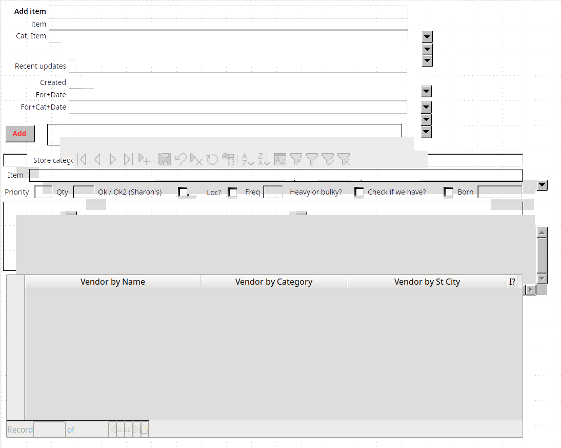

New LO version for me; now trying to edit an old base form. But editor screen layout is really very messed up now.
Screenshot from 2026-03-05 07-06-44
Any way to fix it, short of rolling back to an older version of LO?
Here’s an editing screenshot showing badly overlapped controls, incorrectly placed pull down buttons, gray and white areas in wrong place, etc.:

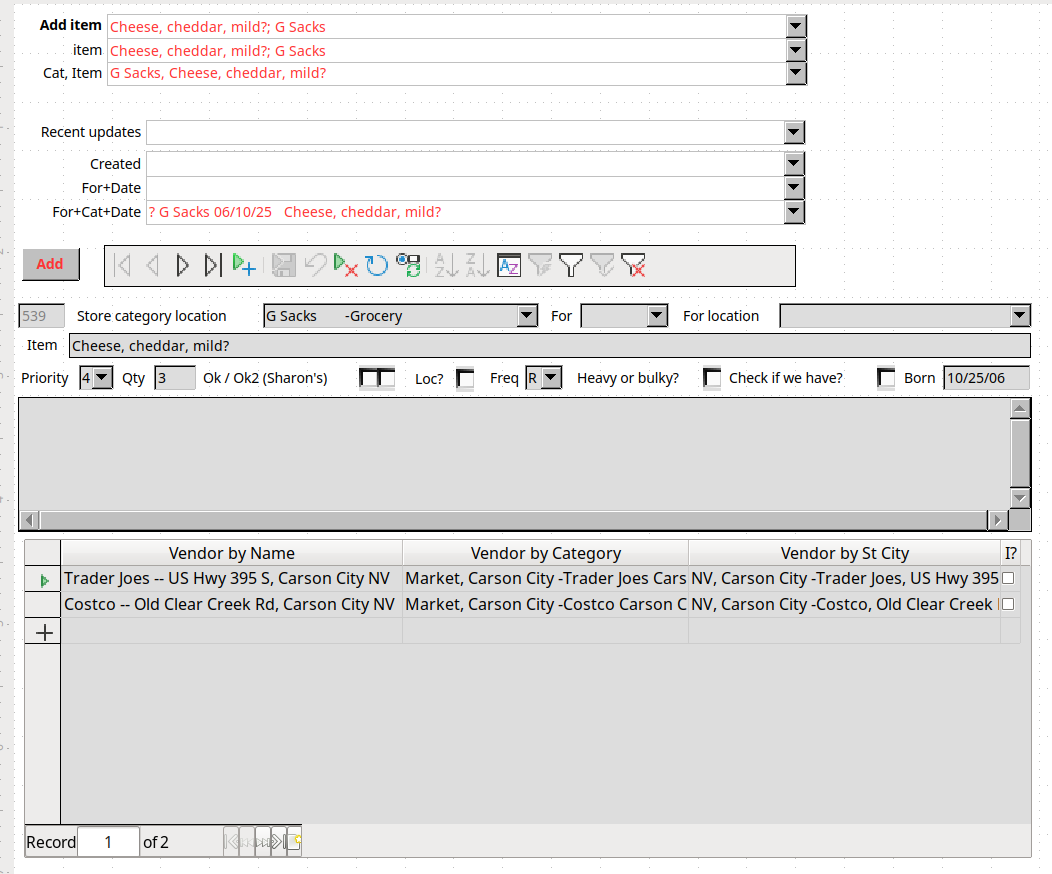

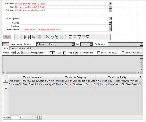

And here is what the form actually looks like:

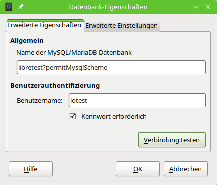

With JDBC connectors you have to look for special connection strings. MariaDB Connector/J 3.0.0 and newer need ?permitMysqlScheme added to the database name:
MariaDB_JDBC_3_permit

But before I did the editing of the .desktop files, I ran the repo version to get a little thing updated. Much to my surprise the Base editor worked like it used to! Not slow and clunky.
Then I checked editing a form, and it too didn’t have the strange format layout that I first reported here.
I was so surprised I had to slap myself and check the About | LibreOffice | Version information. And yes it was the version from the Debian repo that now worked perfectly. What gives? I have no idea. I guess it comes down to the old method of if in doubt, uninstall and re-install and sometimes this matters. – Howard

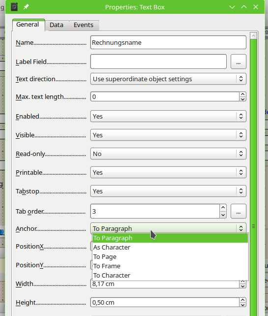

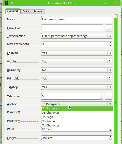

When editing the form, the type of “Anchor” used in each control’s properties will also affect how LO places each control on the form, sometimes making it “appear” scrambled. Try anchoring each control to page and use page measurements to place the controls relative to their page position. Also if a control is to hide another control, the hidden control must be “sent to back” and / or the visible control “to front” by using the control right click Arrange option, or using the control’s Visible property.
  • The “old” page format will need to be duplicated in the new LO version before the form will display “like” the old one.

Take the properties of the form controls:
In the shortcut menu I showed, when I select an option, To Paragraphs for instance, it changes what is found next to Anchor in the General tab for the form controls. So they are the same, and yet they are not. Because in the form controls you have 5 choices and in the menu I showed there are only 3. …??? what a mess I think. Another bug? Thanks Robert for pointing out that Anchor also appears in the form controls General tab. … But all this discussion doesn’t shed any light on the issue I originally raised, especially because it wasn’t solved by this, and even I find it would be very strange that this would have any effect on what I observed (see my first screen shot above when I first asked about this.) … I had hoped to someday get to where I could confront the c++ myself about such things, but I think I’m too old for that. I only hope someone who is younger can dig into the c++. I think the first thing is to read the code and put some comments into it. Those who wrote this code had a pretty good idea of what was what in it, but over the years that is forgotten, and because they left almost no comments in the code it makes it really very hard for a newcomer to figure out what is what, …especially with the huge amount of code that one has to deal with here. Thanks guys.
In Writer the possibility to set anchor to page often doesn’t give the result the normal user expects. A anchor to a page is like fixing the image on a page of paper together with the page number. Many users are irritated from this behavior so this possibility isn’t shown by default. You could change this behaviors by Tools → Customize.
