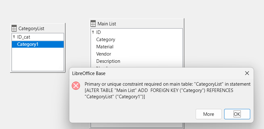

I am trying to link the “category” column of my main table with the “category1” column of my category table. I have an extensive MS Access background, and I cannot figure this out to save my life. No matter what I do, I get the error:
SQL Status: S0011
Error code: -170
Primary or unique constraint required on main table: “MainList” in statement [ALTER TABLE “CategoryList” ADD FOREIGN KEY (“Category1”) REFERENCES “MainList” (“Category”)]

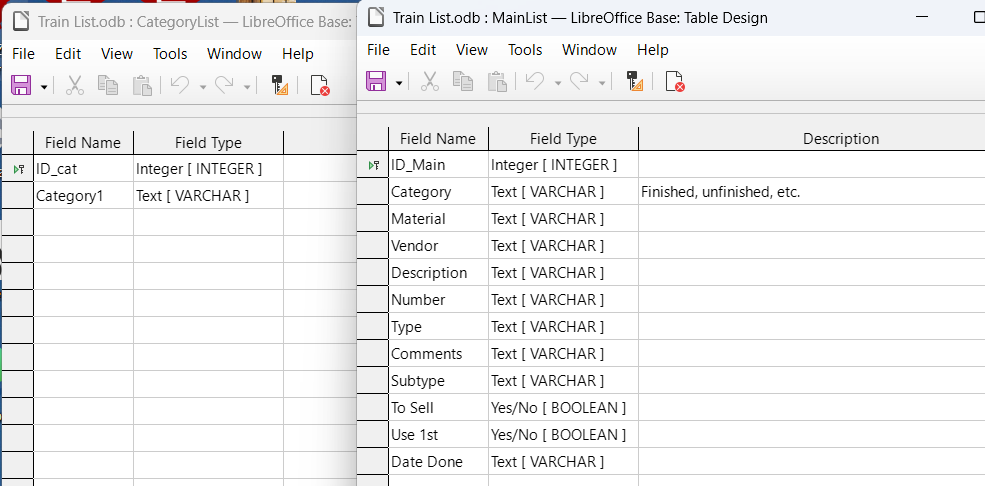

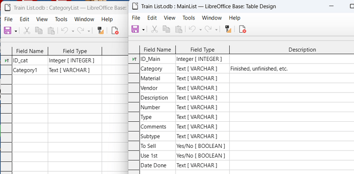

MainList.Category is a simple text column. CategoryList.Category1 is a simple text column.
I dragged Category1 onto Category. Same error.
I dragged Category onto Category1. Same error.
I dragged ID_Cat onto MainList.just-about-everything. Same error.
I dragged MainList.ID onto CategoryList.just-about-everything. Same error.
No matter what I drag from one table to the other, same error. Nothing works. :frowning:

  1. Fields, which should be connected, should always have the same type. “Category” is varchar, same content as “Category1”. You need a field like “CategroyList_ID”, which is Integer. So you could connect this Integer field with the field “IC_cat” of “CategoryList”.
  2. There are other tables with the same problem: Text content is the same as the content in the separate tables. Change to Fields with Integer values.
  3. “Type” shouldn’t appear in the Main Table. Only “SubType_ID” should appear. Every “Type” will be connected to the main table by the SubType.

CategoryList pk is ID_cat, not Category1
ID_cat = INTEGER
“MainList”.“Category” = VARCHAR
As your categories are very simple production status, you CAN have a text pk. It’s legitimate to have short varchars as pk. But then CategoryList will have just the Category1 column = VARCHAR pk.

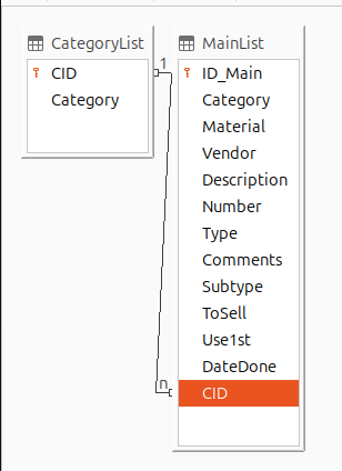

Sample Firebird Embedded with tables CategoryList and MainList with column CID INTEGER fk added.
Inserted Unfinished into the NULL rows.
Now of course drop column Category from the table.
For the real thing use external (not embedded) mode!
CIDs
Trens.odb (18.2 KB)
