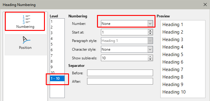

  1. Disable Headings numbering:
  2. Seardh for Headings with numbers at start and deactivates the manual numbering
    • Click on the Toggle Ordered list or Outline format icons in the formatting toolbar until the Heading number disappears.
  • Now the headings should not have any numbers.

Thank you. Step 1 was helpful even though I don’t fully understand it. At some point, I need numbering back (1.1.1). What I did notice was Headings 1 and 2 aren’t even in the list, so I looked at the paragraph style dialogs for them. They don’t even offer Headings numbering, while Headings 3-10 do. (My Heading hierarchy was all messed up in this document, so I had to go through all of them and hopefully fixed them. I’m doing the same with a custom default template (which didn’t need so much work) in hopes I have clean documents in the future.) I don’t understand Step 2 yet, but guessing I will discover it as I’m working on fixing the headings in the document. (I do gather, don’t use those.) I will delete the TOC and start over at some point. For now, what’s there gives a semblance of the structure of the paper.
