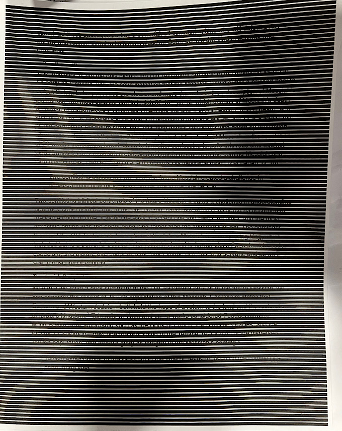

Hello. I recently got a new printer, HP OfficeJet Pro 9730. When I print in “draft” mode from Libre Office Writer version 7.8.2.2 (x86_64), it prints straight thick horizontal lines down the hole page over the print area.
I am using an HP Laptop, x64 based processor, running Windows 10 Home Version 20H2 (which I can no longer update).
The printer worked fine until it did a recent update.

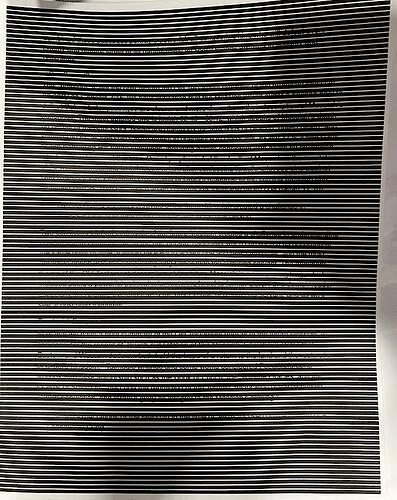

Your new screenshot indicates something else.
Aligning the print heads doesn’t seem to be the issue. The printer prints fine when using the regular print mode. It is only when I use the draft mode that it puts the lines on the paper.
it was working fine until it did an automatic update. I wish I could go back to the version before the update.

In case it is a problem with the document, can you upload the document that is shown your new screenshot?
