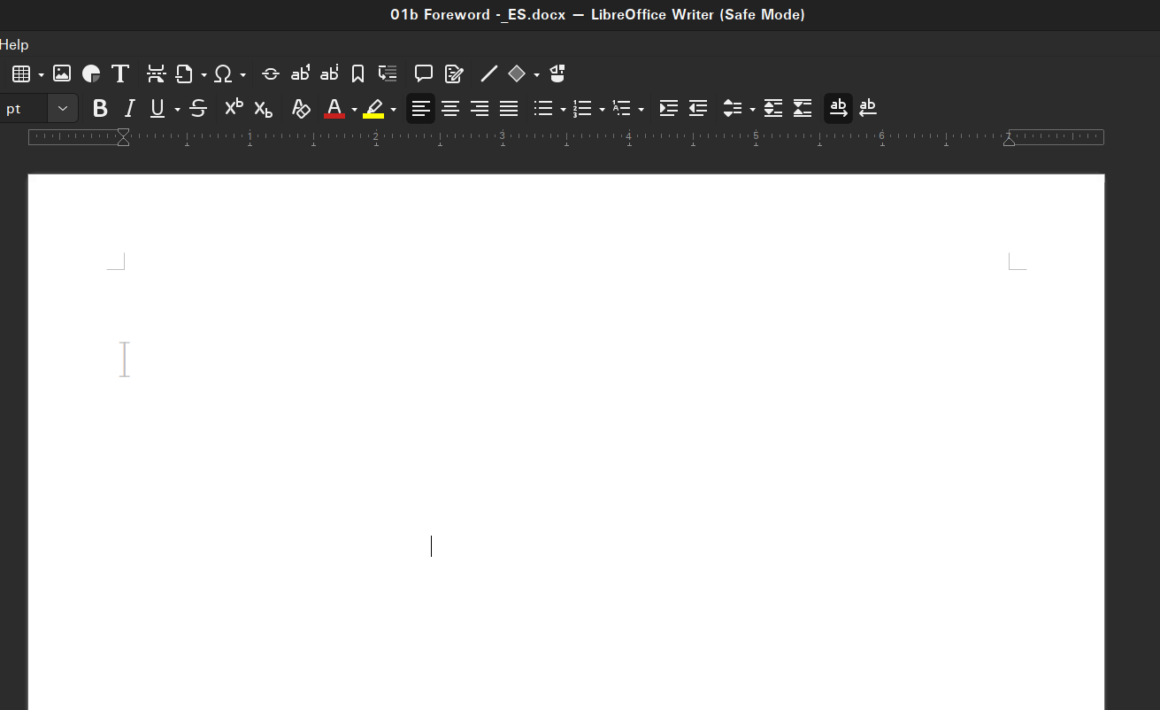

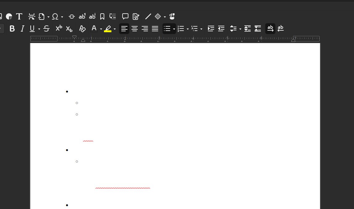

I’m using LO 26.2.1.2 on Ubuntu (Flatpak). I’m having a problem where Writer disappears text, usually when I open certain documents from the filesystem (Nautilus). Looks like this:
The text is there, as you can tell by the red-underline spellcheck warnings. The text color does not seem to be the issue, since changing the text color does not fix the issue. The main thing that fixes the issue is closing the file and reopening it from the LO Writer Open… dialog. To summarize:

Please test with Menu>Help>Restart in Safe Mode.
Unfortunately the problem persists in Safe Mode.

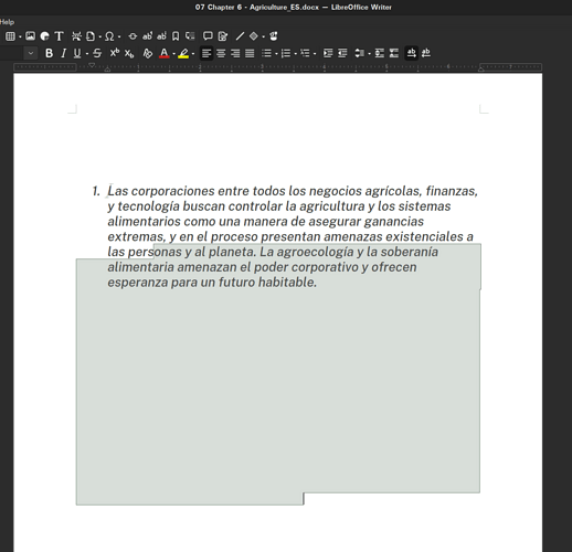

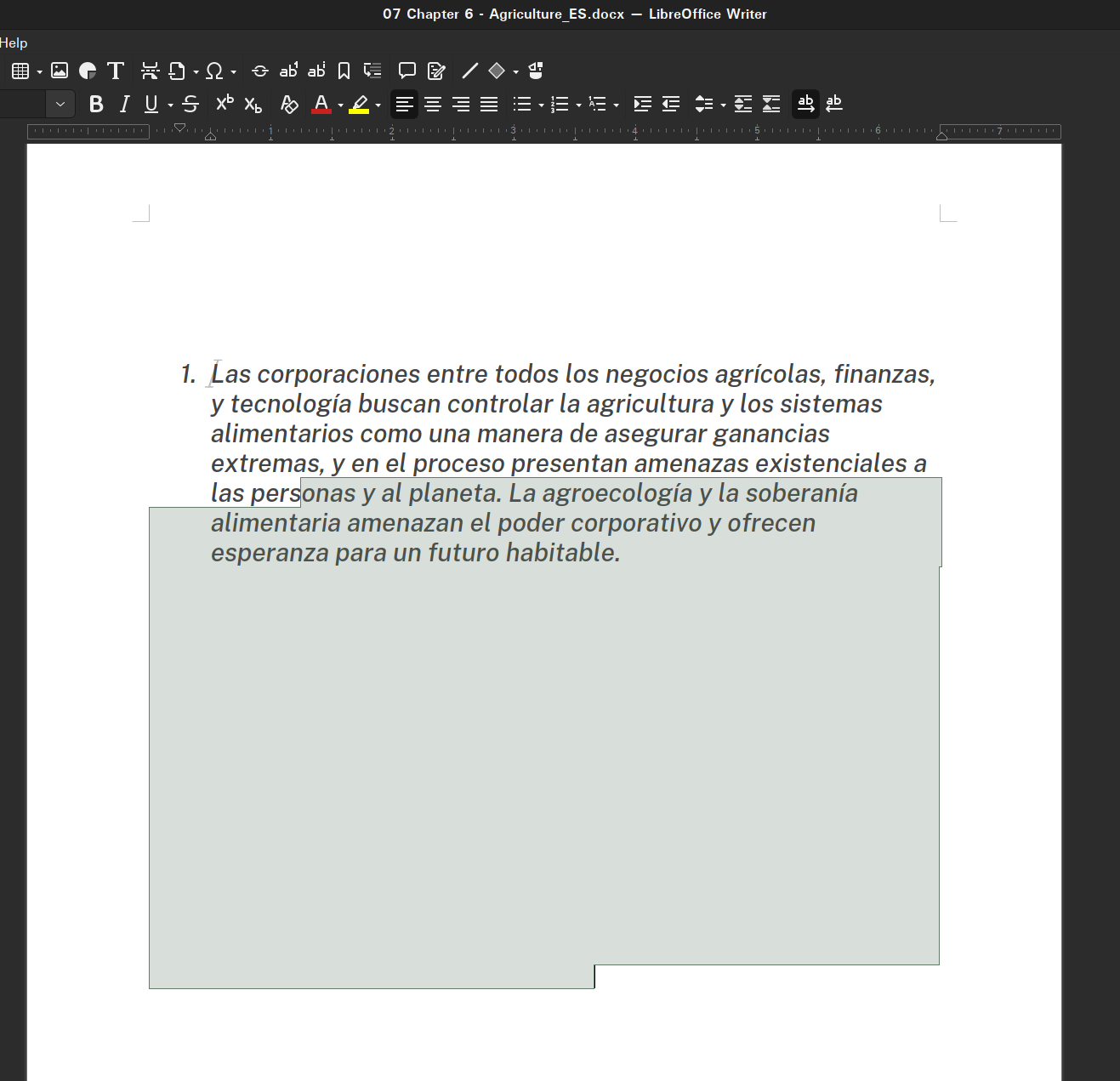

Here is one document that, when opened from the file system, sometimes loads with invisible text. See screenshot:
Opens nice under my Fedora 43, KDE Plasma desktop with LO 25.8.6.2.
Could it be related to your dark OS theme? What happens if you change for a light theme in the OS (and in LO)?
I found you have a lot of direct formatting, notably forcing font colour. Doing so disables completely automatic self-adaptation to themes. Unfortunately, your document is DOCX and you can’t manage such issue with character styles because they don’t exist in this format (reverting to direct formatting).
