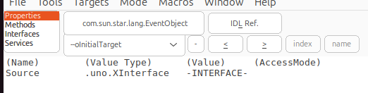

So button click has neither Properties nor Methods ?
:thinking:

what about the Property Source ?!
btw. why do you only provide a Screenshot with the »Property« to be »Visible« for other people?
The object “Event” is not an object “Button”. The Button object is available through the Source property (as the source of the EVENT).
My shameful mistake: simply didn’t notice it!
Sorry :flushed:
My bad: sorry!

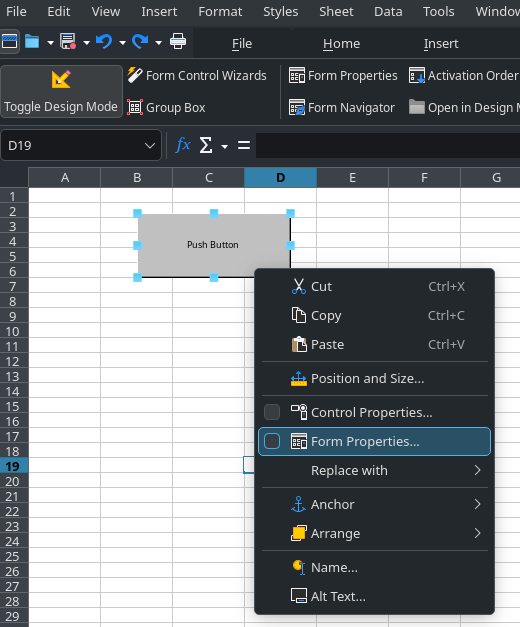

About this: how to get a “real” Form, not just controls spread out into or over the cells?
oForms = oForm.getParent()
@Gbp:

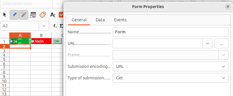

Form Properties… :thinking:
No control without form. Form controls are attached to some dummy form which serves as control container without being bound to any database. Click the “Form Navigator” button on the “Form Design” toolbar and see.

This is like “my” Form. But I would like to get a “real” Form: controls inside a frame, not spread out over or anchored to cells.
And as you can see, I’m not well acquainted with Spreadsheets.
