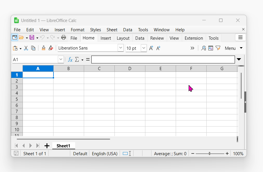

I am on Windows 11. The Groupedbar Compact works fine.
As regards the Tabbed Compact mode:
  • no crash with 25.8.6.2
  • crash as of 26.2.0.3
    recWin11_26222
