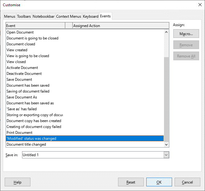

Thank you, this is close to what I am looking for. I have been digging around an I can not find where to attach an event in code.
I wrote the Calc Sheet Activation Event Example for sheet activation events. Which is done by adding a XActivationEventListener via addActivationEventListener() to the SpreadsheetView
I am not able to find how to listen for calculation events in a similar manor without attaching a macro to the sheet events. Any ideas on this?
The “Formulas calculated” is the onCalculate sheet event. This How to set a macro to an sheet-event by a macro - #2 by PYS illustrates how a sheet event script can be set, the sheet’s Events (in BASIC, or getEvents()) exports a css::container::XNameReplace interface at which replaceByName() is used to set a sheet event. It should be possible to adapt the Script property’s value vnd.sun.star.script:... to use the Python routine and language=Python&location=user or similar.
