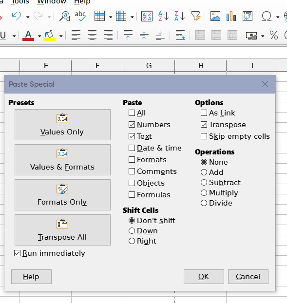

I am on Win10 Pro - recently upgraded to LO 7.5 .0.3 and had no problems before with copy and paste special (column to row) with transpose ticked and Values only highlighted in the Paste Special dialog box and pasting only text and numbers.

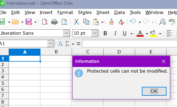

It is now very flaky, works sometimes but most of the time when I paste (after highlighting cells and right click copy with the mouse) into a cell in an adjacent sheet nothing happens or this Information Widow comes up with “Protected cells can not be modified.”. No cells are protected in the ods.

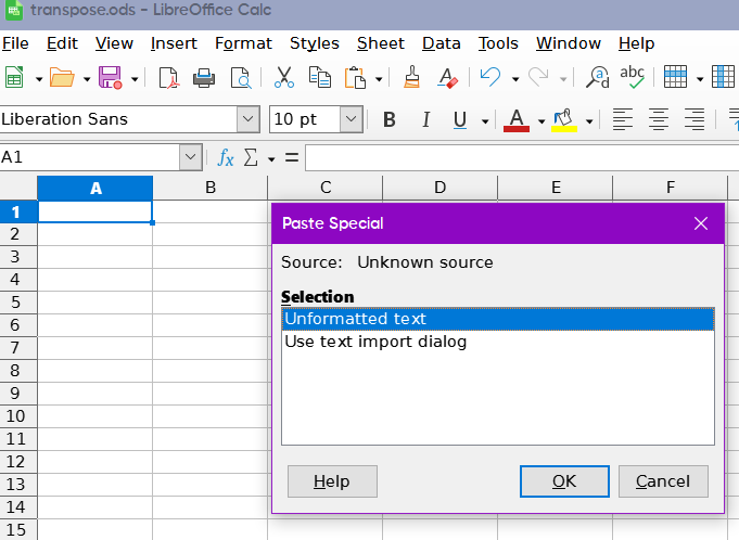

Sometimes when I right click to paste, the Paste Special box comes up saying:
Source Unknown and under Selection: Unformatted text and Use Text import dialog.

Hello Zizi64, can’t uploadad sample as the copied text cells are coming from my main spreadsheet to a new blank one.where the Info box gets dismissed as soon as I press OK I enclose a couple of screenshots: for when I click to paste special
The result:
protectedcwlls-transpose.ods - LibreOffice Calc
And then when I try again this comes up:
textimpoty - transpose.ods - LibreOffice Calc
I really think that for some reason the internal copy is copying the cells as an image instead of text/numbers.
