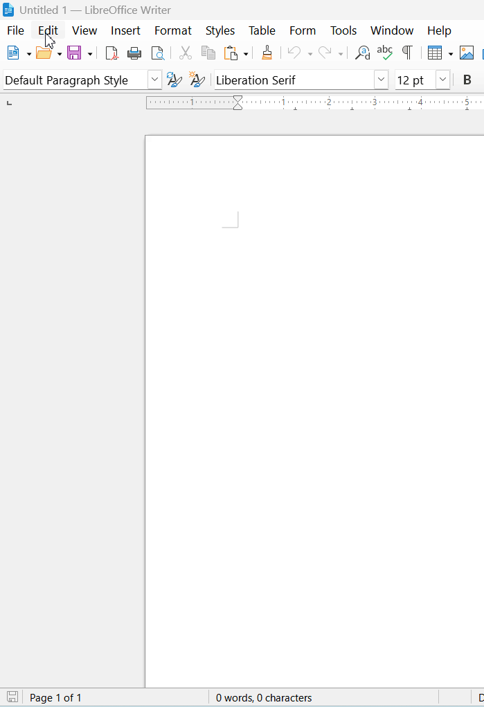

It works on Windows (tested with LibreOffice 25.2.7.2 and 25.8.4.2)
â €
recWin11_25272

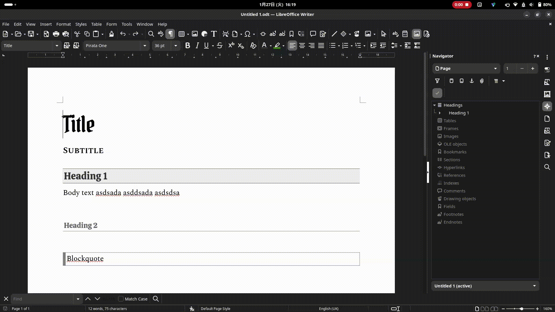

OK thanks. Perhaps the Linux version is missing this feature then.
nav
Perhaps.
In tdf#163734 (“can’t dock a Navigator window to its place on left side of main LO window by d&d”) one reads about issue occuring on Linux.
Works on my (Linux) side. See 163734 – can't dock a Navigator window to its place on left side of main LO window by d&d
