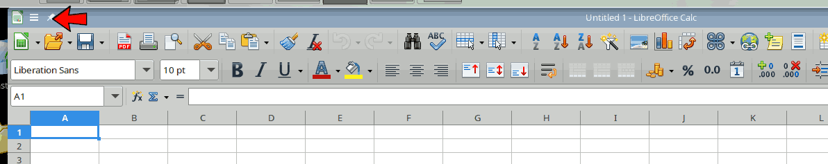

Does this image look like what you have? If so, you can access your menu via the hamburger icon indicated by the arrow.
Yep, all my other applications look a bit like that, and the menu is indeed accessed from the ‘hamburger’. Except LibreOffice, which has no hamburger, nor a menubar. Just an otherwise completely blank window title bar (apart from the title), and then the toolbar directly below it.
(I tried clicking where the hamburger should be, just in case it’s a colours issue, but it’s definitely not there)
