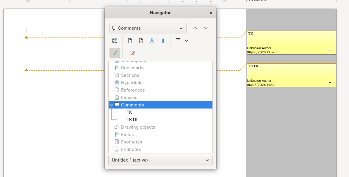

Interesting, I want to be clear why a comment is not useful for this?
It is quite clear and visual, and you can use the browser to find them quickly.
For .odt it would be a more modern choice, but depending on your workflow other options are still valid. For example I have no clue what will arrive if I copy a text into email and the receiver forwards it to some old interface “we use this for 30 years” collecting texts.
So if I would need this I’d use the suggestion by @ajlittoz for an autotext. (For my own documents I simply use @@
If a comment as proposed by @elmau is not your choice (it is my favourite), create an AutoText entry named TK consisting of any sentinel of your choice (e.g. TK or TKTK) upon which a specific character style is applied. Use a custom character style, not direct formatting as a character style will give you more versatility (possibility to change the look of all TK flags simultaneously and others).
How to use the AutoText entry? Type TK and immediately press F3 to make the transformation.
