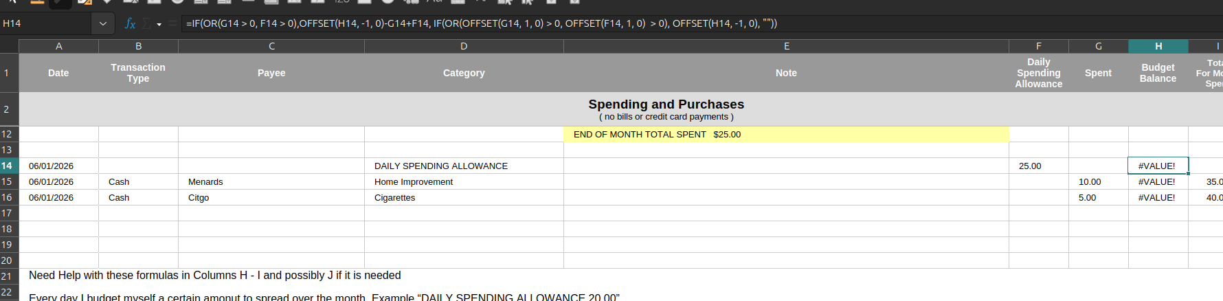

I made a Sheet for my “Monthly Budget” and I’m no good at formulas at all. Basic ones yes, some sheets I use for other things that I made out years ago for calculations and can copy and edit formulas from them when I create new sheets.

then how could you come up with such a =IF(OR(G14 > 0, F14 > 0),OFFSET(H14, -1, 0)-G14+F14, IF(OR(OFFSET(G14, 1, 0) > 0, OFFSET(F14, 1, 0) > 0), OFFSET(H14, -1, 0), "")) ??

The problem, As @fpy has detected is the formula in H14 wich refers another formula (h13) and this is the strange function for beginners

It is, until you insert a new row 14 in the table. The OFFSET -1 from "here" always points to the previous row, while direct addressing keeps the cell anchoring (so an inserted row is skipped).
The problem arises when you add text (an empty string, but still datatype text) and numbers. Calc decides that text and numbers are incompatible (like adding minutes and feet), and returns an error.
This text content is triggered on the first empty row, and causes an error on the next row which receives an amount. The check register sheet you copied from probably avoided empty rows.

Use zero instead of “”.
So in H4:
  • Not: =IF(OR(G4 > 0, F4 > 0),OFFSET(H4, -1, 0)-G4+F4, IF(OR(OFFSET(G4, 1, 0) > 0, OFFSET(F4, 1, 0) > 0), OFFSET(H4, -1, 0), ""))
  • Rather: =IF(OR(G4 > 0, F4 > 0),OFFSET(H4, -1, 0)-G4+F4, IF(OR(OFFSET(G4, 1, 0) > 0, OFFSET(F4, 1, 0) > 0), OFFSET(H4, -1, 0), 0))
Copy down.
It appears that cells are formatted to show zero values as blank, so visually a space vs zero makes no difference.

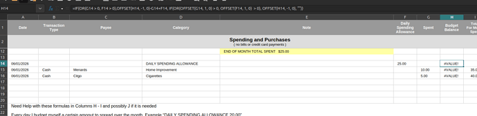

1st. question is: what’s the purpose of H13 =
IF(OR(G13 > 0; F13 > 0);OFFSET(H13; -1; 0)-G13+F13; IF(OR(OFFSET(G13; 1; 0) > 0; OFFSET(F13; 1; 0)  > 0); OFFSET(H13; -1; 0); ""))

My interpretation:
  • If there is an entry in/out on this row, update the previous entry in running sum to reflect those changes.
  • Otherwise …
    • If there is an entry in/out in next row, copy previous running sum.
    • Otherwise (i.e. no entries in this or next row), restart summation (return a blank).
That blank returned is what causes error next time the formula tries to calculate, because it is an empty string (not truly a typeless blank/void) and as such not compatible with calculation.

dannyg - I think keme1 has given you the cleanest solution here. The issue really is that "" (empty text) breaks the math when the formula tries to calculate. Changing it to 0 instead should fix the error, especially if your cells are formatted to hide zero values anyway.
