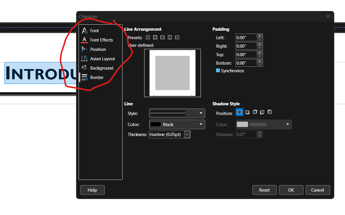

I am using Windows 11 and LibreOffice 26.2, and I’ve just today found that I can no longer select options in the formatting popups. When I highlight text and then use “Format” and then “Character,” the popup appears as normal, but is then stuck in only the border option. I cannot select any other choices.
Here you can see that the text is selected and the formatting popup is available, but I cannot select them.
This is true of all the popups, whether Character, Paragraph, or even the Edit Style popup.

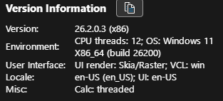

I’m putting a snipped image of the LibreOffice version I’m using.
Should I try to submit a bug report? I’m very new to all this–just started using LibreOffice seriously this year.

I figured out that I can tab through to the panel that I cannot select with my mouse clicks. I can then use the up/down arrows to choose the preferred tab of the context menu.
So this feels like it’s some kind of input error with my mouse. Bizarre.
