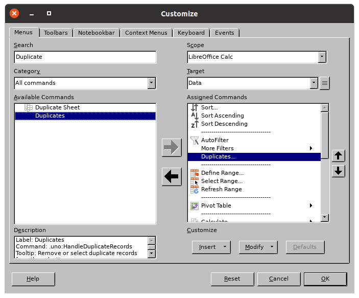

It is likely, that you have customized your menu, and so it is not updated. Check if the function is available in safe mode.

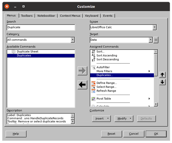

Call Tools>Customize… tab “Menu”, find the command on the left side and move it to the right side.

Thanks Mike. It’s odd. I never customized my menu. But you are right: when I start in safe mode, the Duplicates function does appear. Thanks.
Thank you Villeroy. That solved the problem.
