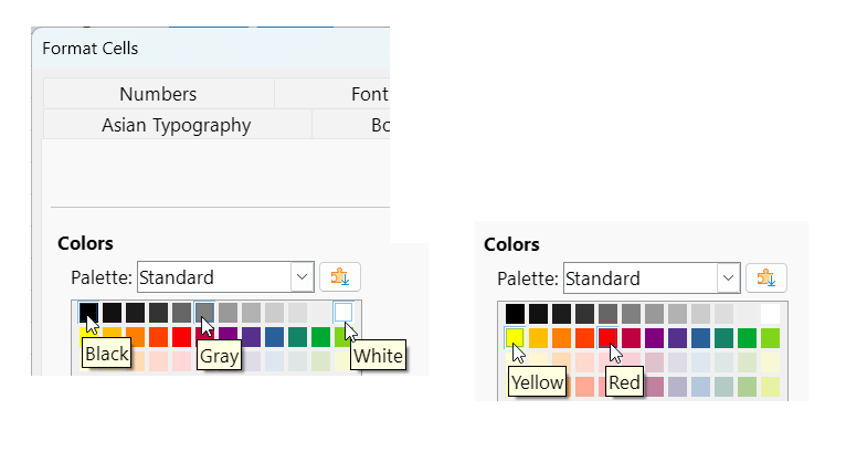

Number Format Code: Not all color codes are saved
It follows that:
  1. In addition to the 8 colors listed in Calc Help, there are two additional, undocumented colors available i.e. BROWN and GREY (BRAUN and GRAU in the German UI).
  2. By default, some color codes in the COLORx format will not be lost when the file is reloaded. Their names will be converted to their corresponding predefined names:
    COLOR1BLACK
    COLOR6GREY
    COLOR12WHITE
    COLOR13YELLOW
    COLOR17RED
