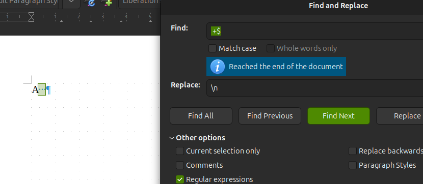

Just so it is clear, you want to achieve this?

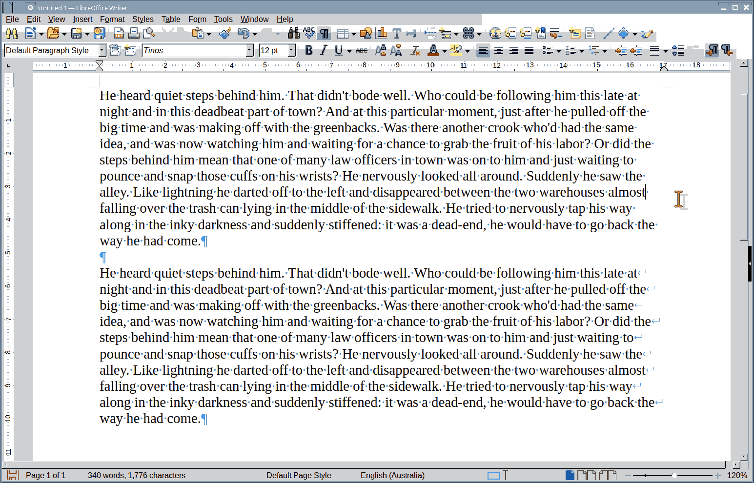

Here’s a sample of what I’m looking for. The AltSearch example almost works.

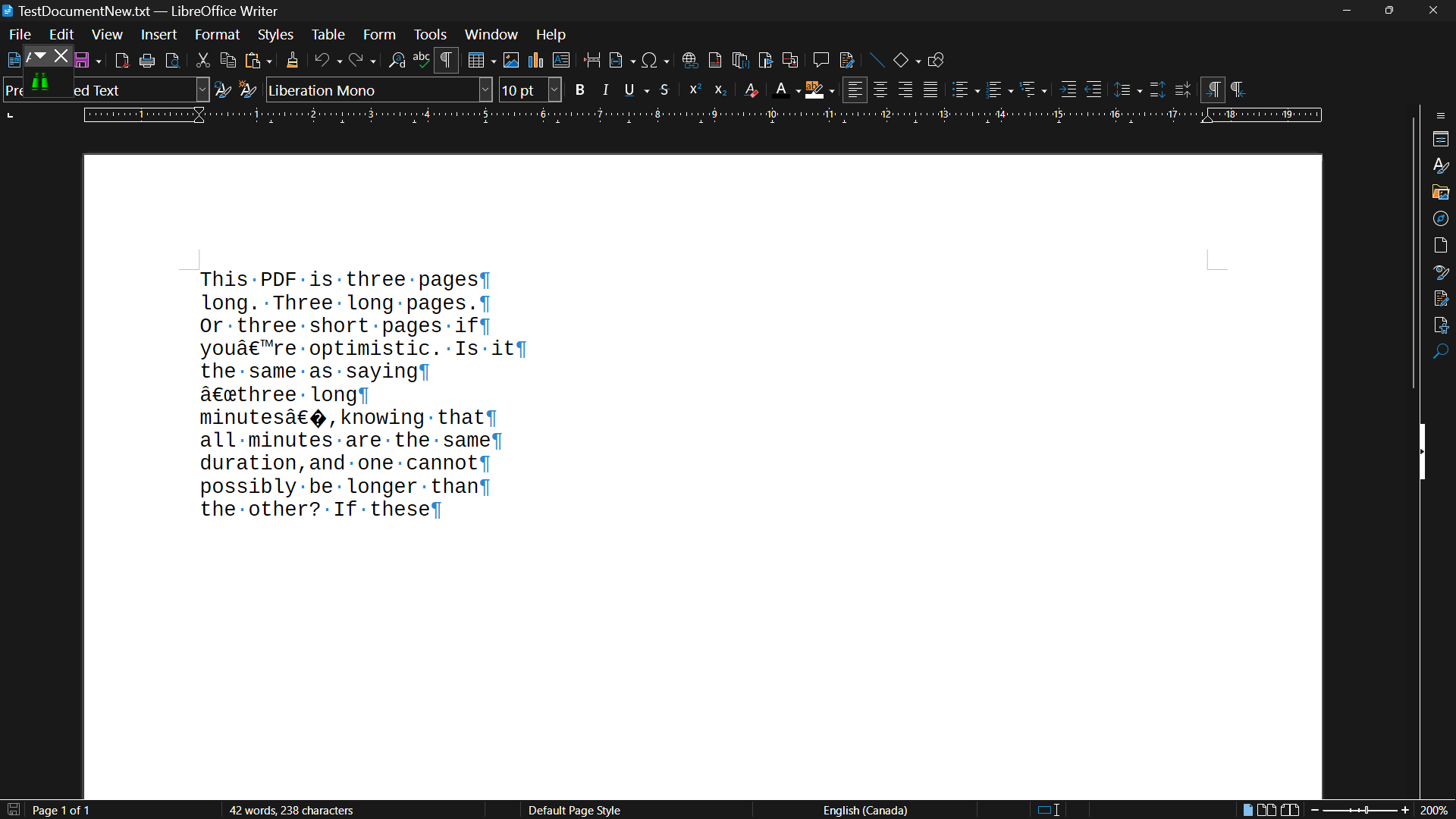

Looking carefully at the screenshot, I notice that character encoding is misinterpreted: plain text is obviously UTF-8 but displayed as some ISO-8859-x variant. So there is already something wrong with the file.
I don’t know what this means precisely. Notepad++ or other text editor seems to be the proper tool but OP is using Writer.
I thought you want line breaks, not paragraph breaks. The expression I gave earlier will work in Writer’s own Find & Replace dialogue if you change the number to 18
If you want line breaks then use AltSearch, I tested this after downloading the latest version:
Find: (.{18})(\s)
Replace: \1\n
So the gibberish text is from a test document and irrelevant. I’m on a quest to do this because I need to reformat these files for teleprompter software so that there is less to do in the actual teleprompter app. The (.{18})(\s) example is selects text about midline and therefore puts the line breaks in the wrong place.
