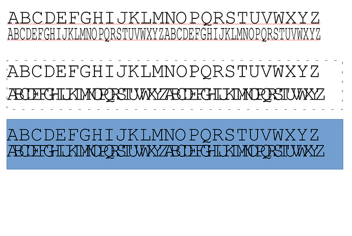

Character "scale width" does not work in Text Boxes and Shapes
The wider text is 100% scale width. The narrower text is 50% scale width.
The upper text is in the document body.
The text in the dotted area is in a Text Box.
The text in the blue-shaded area is in a Rectangle Shape.
I’m not sure if there is a workaround to make “sale width” works in Text Boxes and Shapes.
I used Courier New font.

Sorry. I didn’t mention my OS. It’s Windows 10, 64-bit.
LibreOffice 7.0.2.2.
