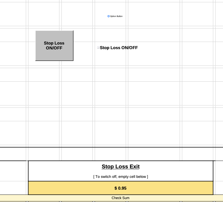

Hi All,
Is there a way to make Checkboxes or Options boxes larger? I’ve tried inserting both into my sheet, and they’re so small as to be practically invisible.
Push buttons are easily resizable, but are only momentary, which I assume would take some heavy duty programming to give them “latching” behaviour properties.
Sorry for the beginners questions, and thanks in advance to anyone who can help.
Kind regards.
CT

No, this is not your problem, this is a feature of this particular spreadsheet - it is structured a little differently than Excel or Google Sheets.
Perhaps reviewing the thread this link points to and the discussions surrounding it will help you decide to move away from controls in the sheet when designing your user interface and instead use formatted cells - this will require much less code and extra formatting effort.

Our community has developed several alternative approaches to solving this problem. Two of them, for example, are shown in this discussion. The first example - SumByMarked.ods - uses a simple macro that is triggered by double-clicking on a cell with a checkbox image (cells with checkboxes are marked with a separate style so that the macro does not confuse them with neighboring ones). In the same topic, our respected colleague @Lupp made a reasonable remark that the presence of a macro in a spreadsheet can cause concern among users. Therefore, a little further down, a solution without a macro was proposed - SumByMarkedWithoutMacro.ods. Here, instead of a checkbox, a drop-down list with two values ​​is used. It’s very easy to create such a list -
SimulatingCheckbox
However, creating checkboxes in a spreadsheet with a macro is not much more difficult - the entire process is described step by step in this message.
As for the question posed in the title of the current discussion, @Regina gave the answer in September 2014: unfortunately the statement ‘will NOT scale’ is true. The checkbox is not drawn by LibreOffice itself, but it is the common checkbox of the operating system
