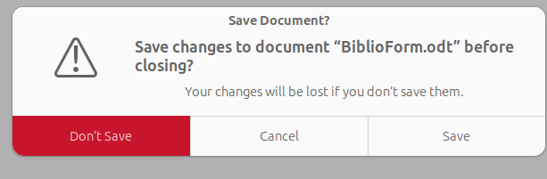

Code to save the connected .odb when closing the Form
Hi.
After failing to pass the filter to DoCmd in Access2Base - to open a Report
I parametrized @Villeroy’s free floating Form.
It works fine. But of course, when closing, it asks for saving the biblio.odb.
How to code this on closing the form?

It asks to save the form document (.odt). You can avoid this message by making the file read-only on file system level or by setting the read-only option in the document properties.

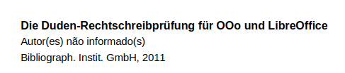

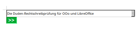

Sure: I pass the parameter from List Box to the Report’s source query.

It may be asking to save a modified Writer document or modified form data linked to the “biblio” table. Bibliography.odb remains unopened and untouched.
