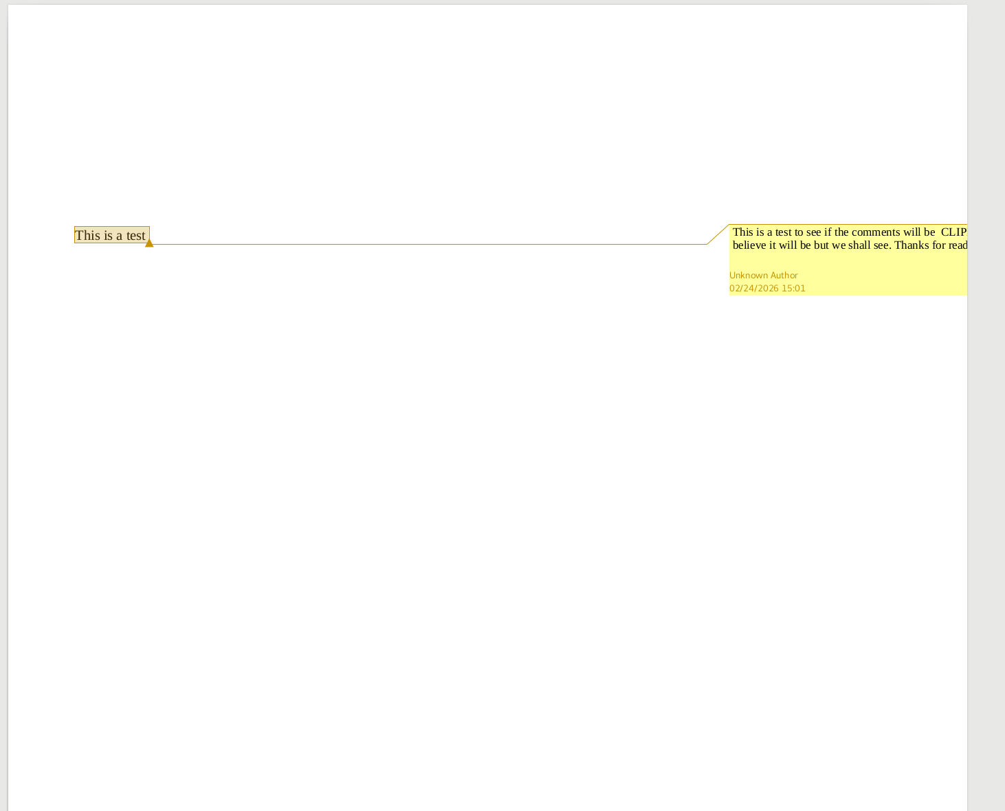

I am experiencing a regression in LibreOffice where comments exported in the margin using the ExportNotesInMargin PDF export option are clipped on the right edge (I have added an image example in this feed) . I have done it manually and in code and both do not work. Currently in my code I am taking a docx and using this argument below to export it as a pdf with comments in margins.

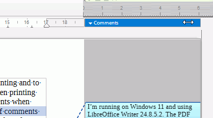

Drag the comments bar to be narrower. For my test, 60 mm wide exported OK (default is set to 80 mm). The setting appears to be persistent, so a one-off adjustment for all documents.
SetCommentBarTo60mm

Yes; that bug is a duplicate of tdf#163194, which is fixed in upcoming 26.2.1.
As to workaround: set DisplayWidthFactor in expert configuration to 1.8 (which will make the screen size of the comment area narrow on HiDPI screens, but it is the value that is correct for export).
