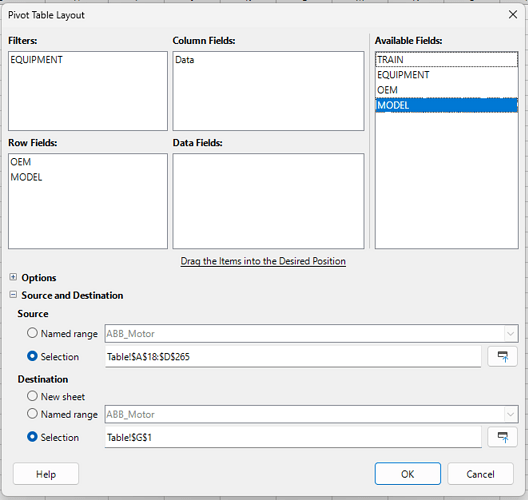

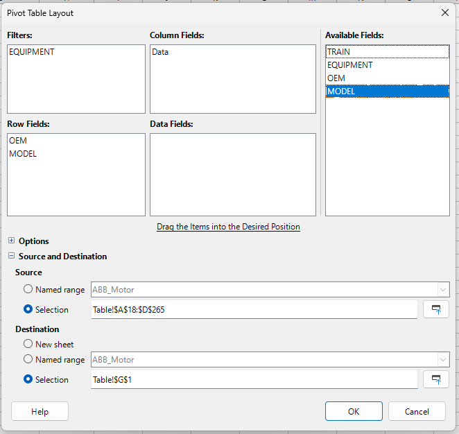

I have been using Excel for more than 20 years, but rarely use Pivot Tables. I’m moving away from Excel completely and trying to do everything in Libre Office. I am truly baffled by how the Pivot Table functions in Calc. I understand how it’s “supposed” to work, but I don’t understand the output, based on what I’m doing in the Pivot Table Layout dialog box.
Questions:
  1. Why is “Data” always in the Column field? I understand what it’s doing. It’s trying to count or sum a number based on the row item. But I don’t have any data. These are just lists of equipment by OEM. So the “Data” column just shows up as “empty”. Which makes sense because there is no data, but the column is not useful in this instance, and I can’t get rid of it.
  2. When I select the range to place the Pivot table, why can’t I edit the field with F2? I have to click in the box, or double-click the cell for the upper left corner of the Pivot Table. And F4 doesn’t appear to work to lock the cell reference. That happens automatically when I double-click the cell for the destination.
  3. Does the data range for the Pivot Table automatically adjust to capture new data? Or do you need to edit the Pivot Table each time new rows are added? Seems I can’t use F2 to edit this value either. I have to click in the box to enter edit mode.
  4. Does it make more sense to put the data into Tables in Base and link that data to the Calc spreadsheet?
Thanks in advance. I have tried to answer these questions on my own with the Calc guide, but I find the text description to be lacking in detail and a bit ambiguous.

This only matters when there is more than one data field.
Just enter F2. The address is always an absolute one.
This behaves exactly like any other spreadsheet reference. The cell formula SUM(A1:A99) expands to SUM(A1:A100) when you insert one row.

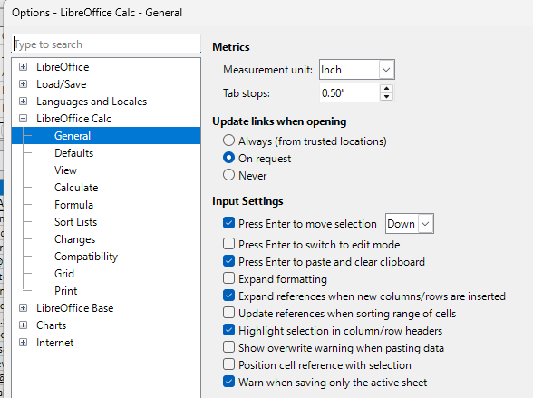

In order to make this happen more reliably, you have to check option Tools>Options>Calc>General>“Expand references when new rows or columns are inseted”. With that option being off, references do not expand when inserting new cells directly below/behind. You have to insert within the range.
Yes, of course. The learning curve is much steeper, but in the end you get something that is easily and safely usable for many years.
This is what the pivot in your screenshot does. It selects existing combinations of OEM and MODEL for the selected EQUIPMENT.

I tried that, but it wasn’t working. I had to click the cells behind the dialog box, and then click again to get the pink halo that indicates which cell I selected. Only then did the absolute reference get populated in the range field.

This option is checked, but when adding new data to the source table, the next row is not automatically added to the range.

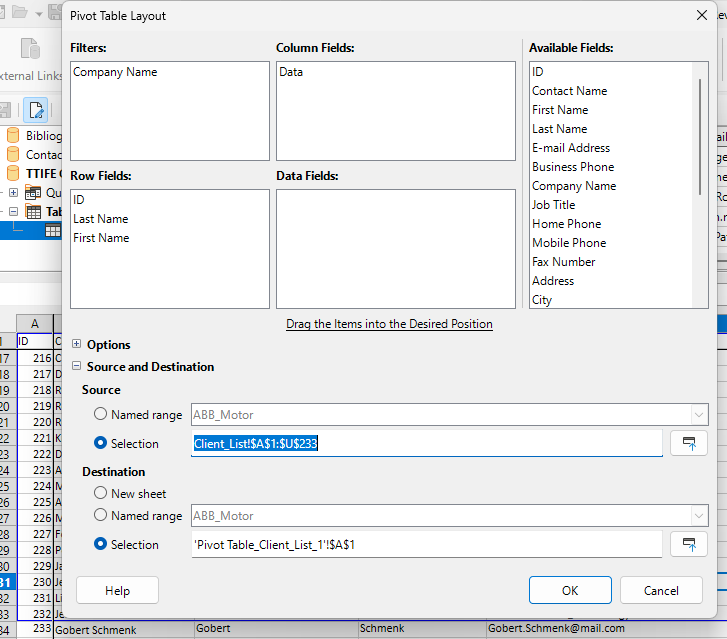

In this case, I added a fictitious name and email, and the range is not updated.
But the option is enabled in the Tools setting in Calc.
You’ve got to insert cells (or entire rows) anywhere within or directly below the referenced range. This will expand all references in formulas, named ranges, conditional formatting, validations, list boxes and all kinds of source ranges.

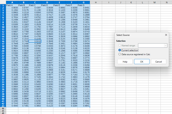

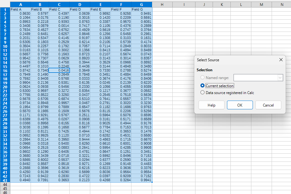

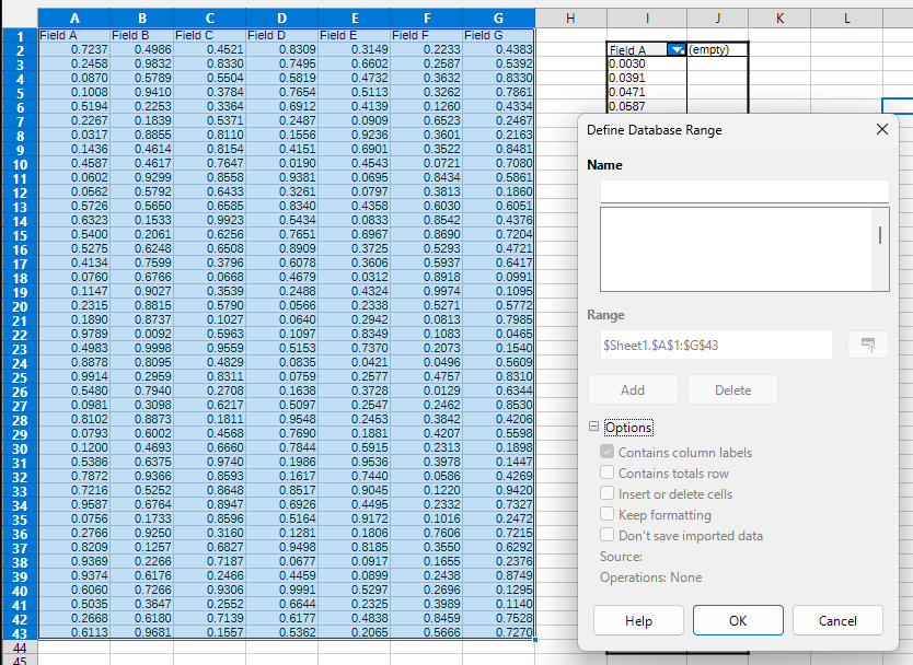

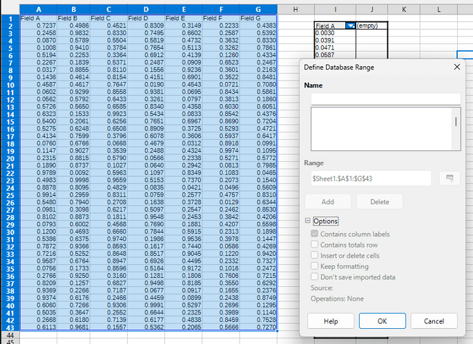

Late addition. I just stumbled onto this while typing this post.
Is this what I’m looking for?
