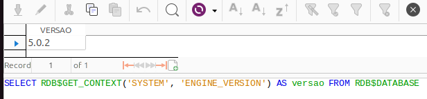

The internal driver of LO supports only Firebird3. So you couldn’t connect to Firebird5 with this driver.
Only possibility to connect to Firebird5 is to use JDBC or ODBC-connection. So you could connect to the Firebird file through a Firebird server.
:grey_question:
