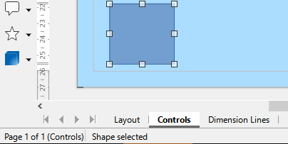

You can see at the status bar in which layer the selected object is.

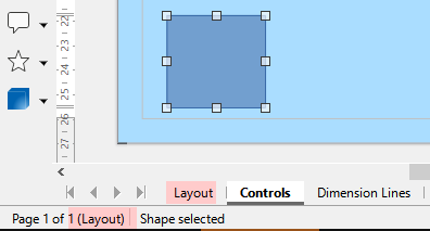

If do you cut, and paste while another layer is selected, the object is pasted in the new layer.

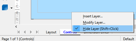

By hiding a layer, the objects in it will hide.
