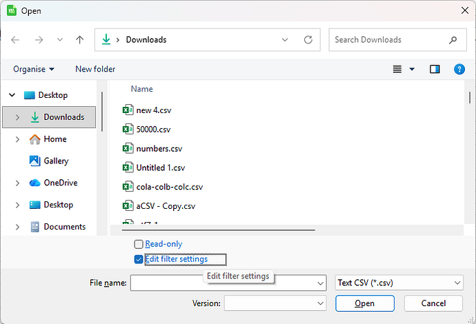

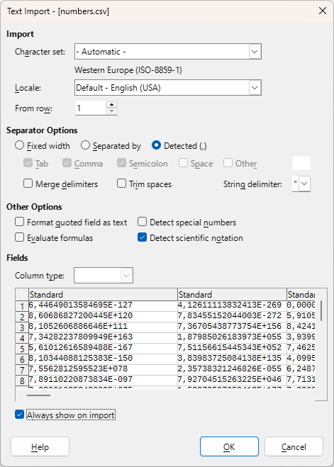

This means, that you have unchecked the new checkbox “Always show on import”, appeared in the Text Import dialog in v.25.8 - see at the bottom in the screenshot:
By default, it is checked; so no, it does not remove user control - to the contrary, it increases that control; it does not force “awkward workarounds” - it is a user choice. And - what’s more important: you can always re-enable it again: just use File Open dialog; in file type selector, choose "Text CSV:; then check “Edit filter settings” checkbox (to override the preference once) - and you will get the wanted dialog, where you now can select to show it from now on.

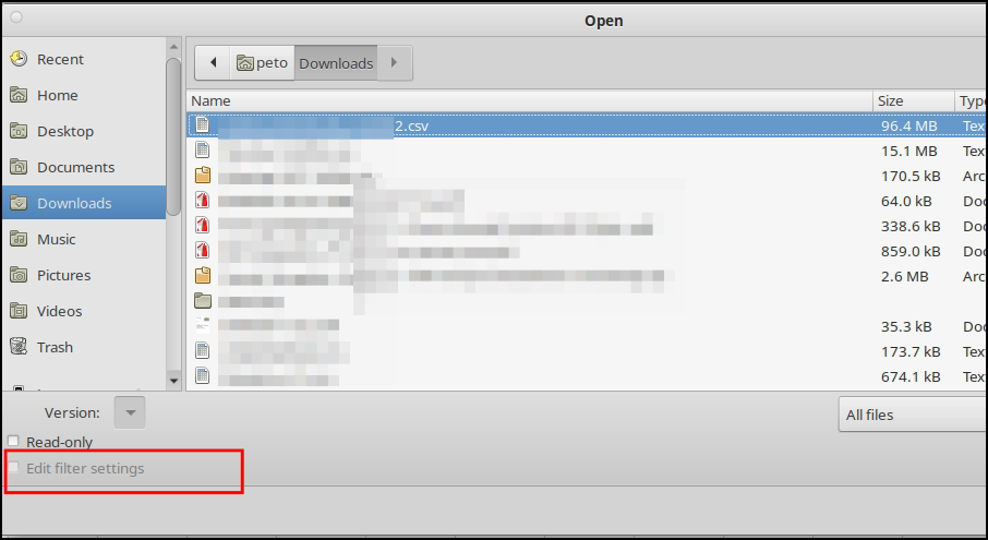

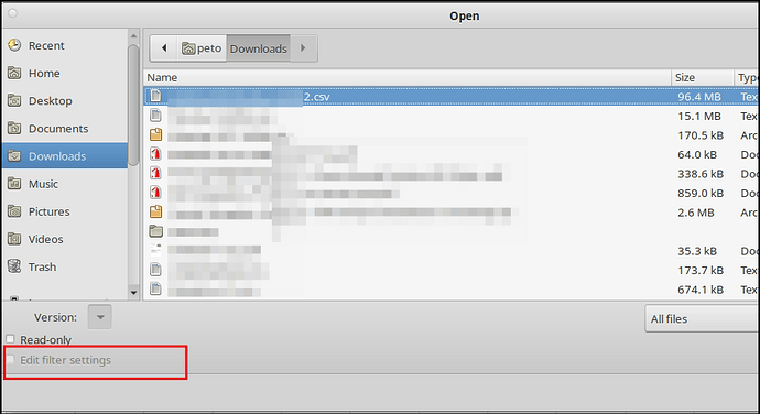

For the lastest update 25.8.6.2 the Edit filter settings is greyed out and any csv always opens without Text import and ignoring any delimiters, only thing I can do Data → Text to Columns, which is a huge step back.
I see your dialogue is set to “all files”.
Did you try to set this to csv as in above post by @mikekaganski
oh, sorry, I did not, but now when I do, it is still not offering the wizard the next time, like described by @mikekaganski
The first time the wizard opens, tick the box Always show on import
Thank you now we went full circle…the question still is how to make it show the first time as the original explanation does not work.

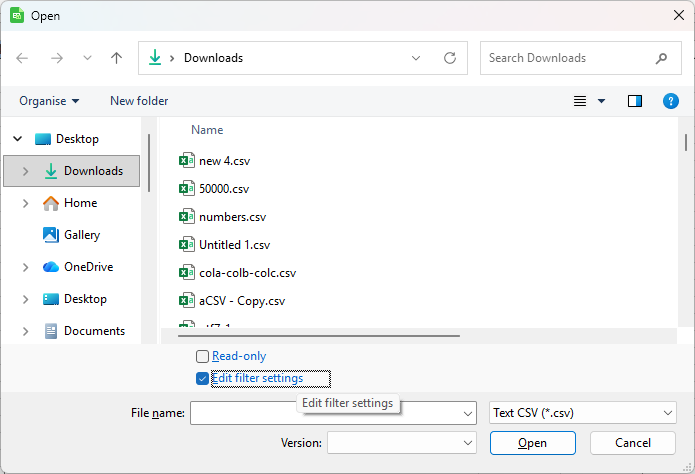

  • I scrolled down the File Types dropdown, under Spreadsheets to Text CSV (.csv) and selected it.
    TextCSVFileType
  • The Edit filter settings box then became available.
  • When the Text Import dialogue appeared I made sure to tick the box Always show on import
Thanks, This worked for me…
