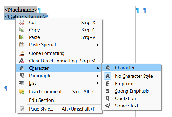

A quick look and it can be done. For this, I am using Video Spine labels which print in portrait with the text left to right.
  1. Add the Call Number field to the first label
  2. Select the field and click Format > Character.
  3. In the Position tab, under Rotation/Scaling select 90 degrees. OK
  4. Now you need to add the horizontal fields but you could run out of space if you enter a return to separate the text. First add a frame,
    1. click Insert > Frame > Frame interactively and draw a frame inside the label.
    2. Select the frame, right-click it and select Properties.
    3. Click the Border tab and remove all borders of the frame
  5. Click inside the frame and add the Title field and the Author field
  6. Press Ctrl+F2 to open the Fields dialogue. In the Database tab select Next record and click Insert
  7. Click Synchronise Labels
Print a few records to pdf to check.
