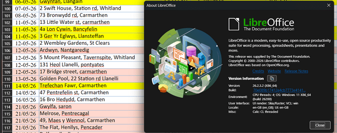

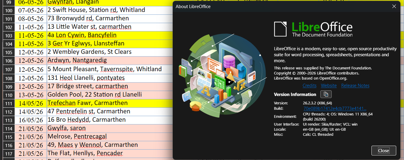

This is on the Libre office spreadsheet since the latest update - I can’t see where i can find the version i am using
Windows 11 pro is the OS

Open Menu: Help → About LibreOffice
2026-05-25 11 22 20
Then there is exactly one expert for your problem to ask: @dyfedrob
(We here can not see, what version your “latest” update may be, if you have automatic updates activated, your profile was reset, is corrupted or what is inside your file. So not much help possible.)

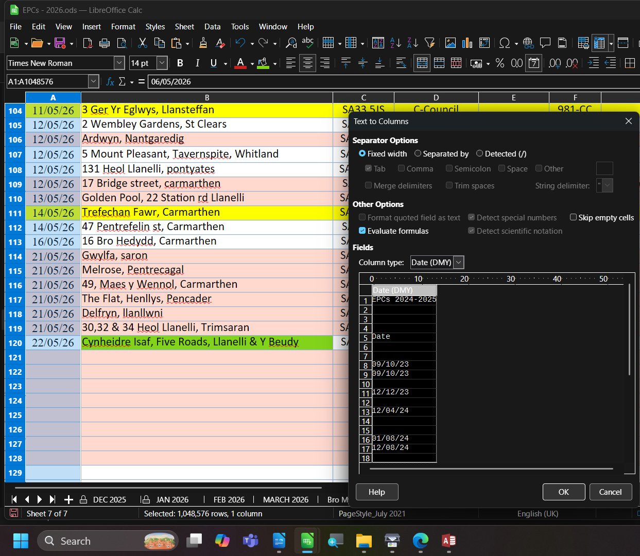

select the Column in Question and:
⇒ Data ⇒ Text to Columns set no delimiters at all, but change the Column-type from Standard to Date (DMY)
I tried this but it keeps reverting back to “standard” once I try to input a date in the column, which results in the reversed date each time ?
Screen shot attached

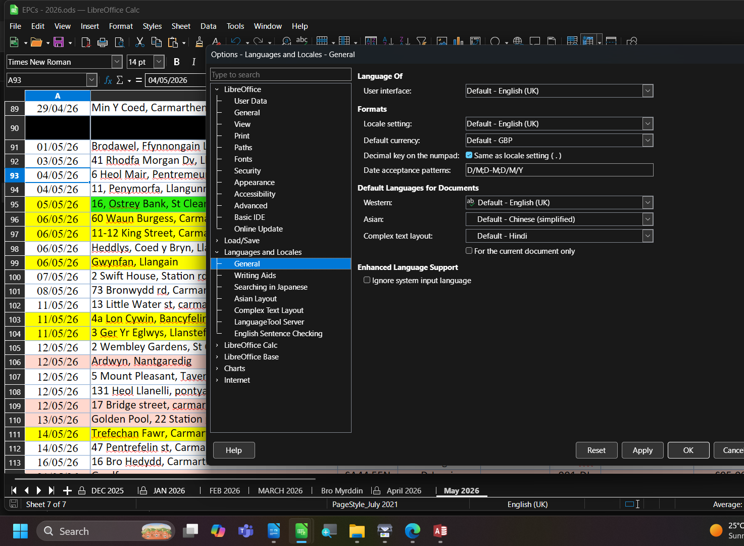

Menu / Tools / Options / Languages and Locales/ General
Please share a copy of this screen.
Thanks…
Thank you!
So, Calc assumes (Date acceptance patterns) that you’ll enter dates in the following formats:

When I do this experiment myself, I set the language of cell A24 (Format Cells / Numbers) to English(UK)
After entering the date, I see “25/05/26” because cell A24 is formatted as DD/MM/YY.
