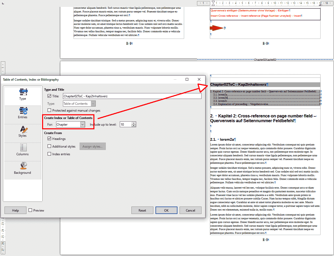

EDIT
Writer itself seems to define chapters by Heading 1 when generating a ToC. You surely could “play” with some properties of the ToC dialog. See attached screenshot:
Regarding the “chapter TOC” feature, word Chapter is highly ambiguous.
First, as I mentioned earlier, there no agreement on a formal definition of “chapter”, i.e. which kind of division is this.
Second, a “partial” TOC can be inserted anywhere. Therefore it has to be context-sensitive.
Developers chose to adopt word “chapter” for the starting point/level for the table. The location of the partial TOC defines the starting level from the outline state at this location. For example, if you are presently below a Heading 3, the starting level will be 3. The ending level is under your control because there is a field in the dialog.
However, since there are as many requirements as users, I am not satisfied with the present feature. It has been implement in kind of one-size-fits-all. I’d like more control on the starting point.
If I insert my “chapter” TOC immediately after the “chapter” heading, I prefer not to repeat this heading because it is visible immediately above. This is not possible. And what if I want to list shallower levels as a reminder in a long long document (e.g. level 1 & 2 for a level-3 partial TOC)?
For these reasons, I’d like to be able to request the starting level to be listed in the partial TOC. Caution! This does not mean that TOC scanning and collection would start on the indicated level; no, these shallower levels are only “one-shot without dependency” reminders and could be captured from the context. TOC scanning should start at level+1 and end where you asked for. Otherwise the “partial” TOC does not comply with its expectation.
PS: in very old releases, “chapter” was hard-wired to level-1 and partial TOCs in deeper levels were automatically faulty.
