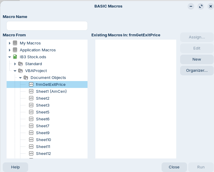

The object is left over from a previous project which was was exported out but this form and its handlers were left behind. I assumed it is a simple delete, only to clean-up the file.
The response from an LLM was there is no delete-object function in librecalc, hence my asking to confirm.
The object is visible. But no visible way to delete it.

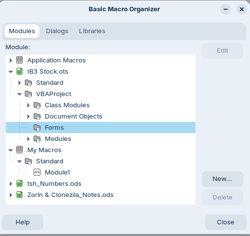

  • Try to go to the Organizer via the button. Maybe there are mor options.

Not knowing what the organizer is, I did not try it.
However, when I go there I see the generic Forms category but there is nothing under it, and I suppose for that same reason the Delete is grayed out.
We can call this question closed, and the LLM was likely right, in that the form is stuck in there forever, until the project is rewritten completely.
