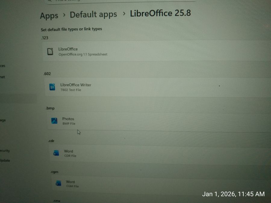

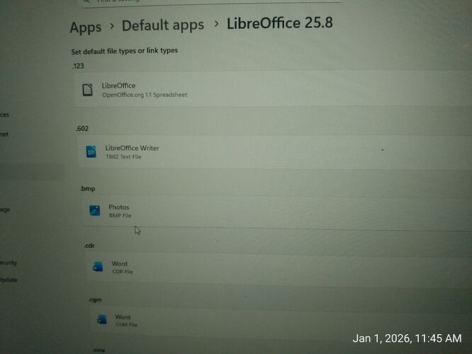

So when I try to assign the files to libre it does it but it does not hold it , it goes right back to not even being done

There are several methods to do this described in the following link. I usually use the method to right click on a file and use “Open with”. Don’t forget to select the Checkbox next to “Always…”
Actually you can use “this product”. Just start LibreOffice itself and then use Open from File-Menu. The association of .odt or .ods to LibreOffice is additional convenience, to invoke Writer/Calc, if you double-click a files icon.

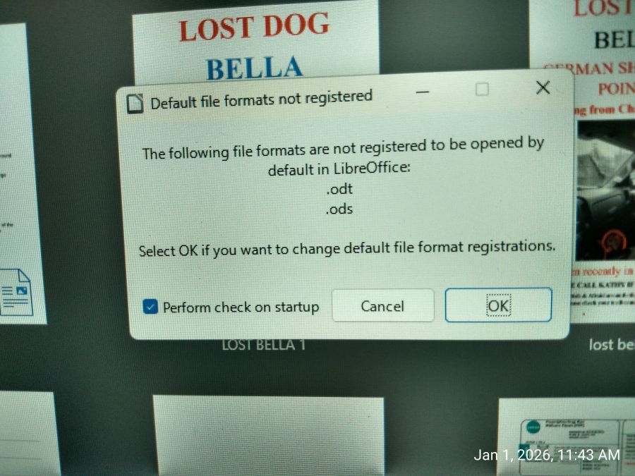

When I got this message a few years ago, I turned off the “Perform check on startup” option and clicked “Cancel.”
It’s been working ever since.

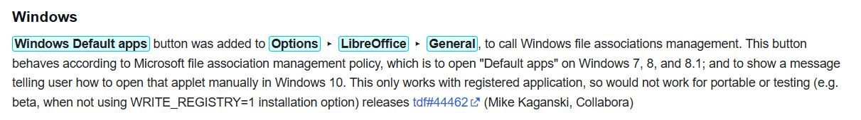

This test has been available since version 7.0.
LibreOffice 7.0: Release Notes

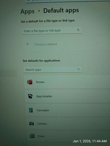

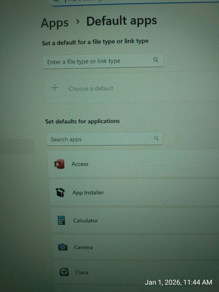

HELLO, Happy New Year and thank you very much. I went to the app set defaults for anything that said word to libre office and now everything is working, I can edit, etc. There surely was a very long list of extensions for Word . So, I thank you very much. Sonia
