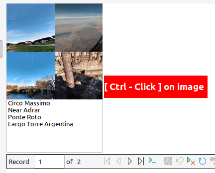

Event = Image Controls > Mouse button pressed
CtrlClick on the image:

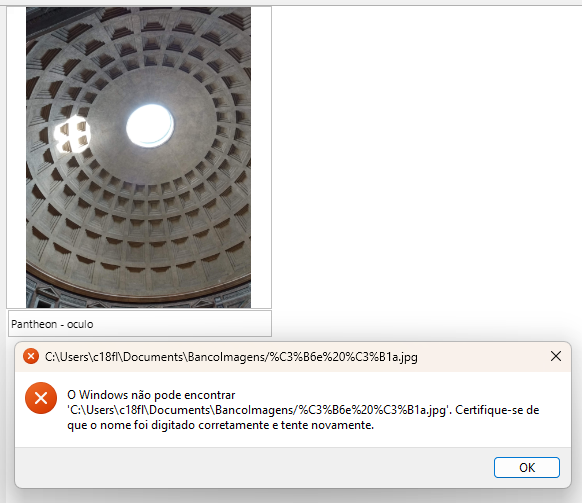

However, an error occurs when opening the file if the name has an accent mark. For example: “José Coronado.jpg”, “Virgílio Castelo.jpg”, “Zöe Saldaña.jpg”, “Totó.jpg”, “Milène Demongeot.jpg”, etc…
Which means I will have to change the name of all files with accent marks. Which won’t be a big deal!

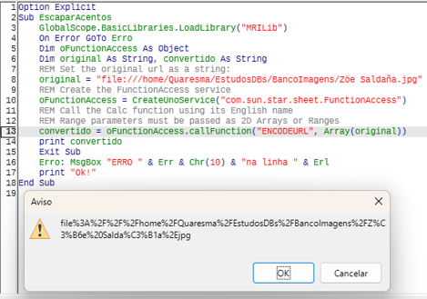

You can try this code as a function (build a function with a string parameter returning a string) ON ANOTHER FORM.
Ref: Google AI
Option Explicit
Sub EscaparAcentos
    Dim oFunctionAccess As Object
    Dim original As String, convertido As String
    REM Set the original url as a string:
    original = "file:///home/Quaresma/EstudosDBs/BancoImagens/Zöe Saldaña.jpg"
    On Error GoTo Erro
    REM Create the FunctionAccess service
    oFunctionAccess = CreateUnoService("com.sun.star.sheet.FunctionAccess")
    REM Call the Calc function using its English name - parameter must be as an array!
    convertido = oFunctionAccess.callFunction("ENCODEURL", Array(original))
    print convertido
    Exit Sub
    Erro: MsgBox "ERRO " & Err & Chr(10) & "na linha " & Erl
End Sub
stUrl = convertToUrl(arUrl_Start(0) + stField)
stUrl = FuncaoEscaparAcentos(stUrl)
oShell.execute(stUrl,"", 0)

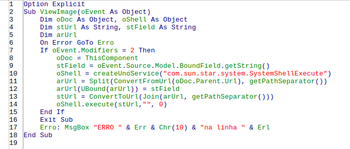

The problem is in these lines:
arUrl_Start = split(oDoc.Parent.Url, oDoc.Parent.Title)
Replace description:
Dim arUrl_Start()
to
Dim arUrl
and use this version of the fragment:
arUrl = Split(ConvertFromUrl(oDoc.Parent.Url), GetPathSeparator())
arUrl(UBound(arUrl)) = stField
stUrl = ConvertToUrl(Join(arUrl, GetPathSeparator()))
Additional bonus: the document’s Title property, which can be changed by the user or a macro, is not used.

:thinking: @sokol92’s code works fine here to me.

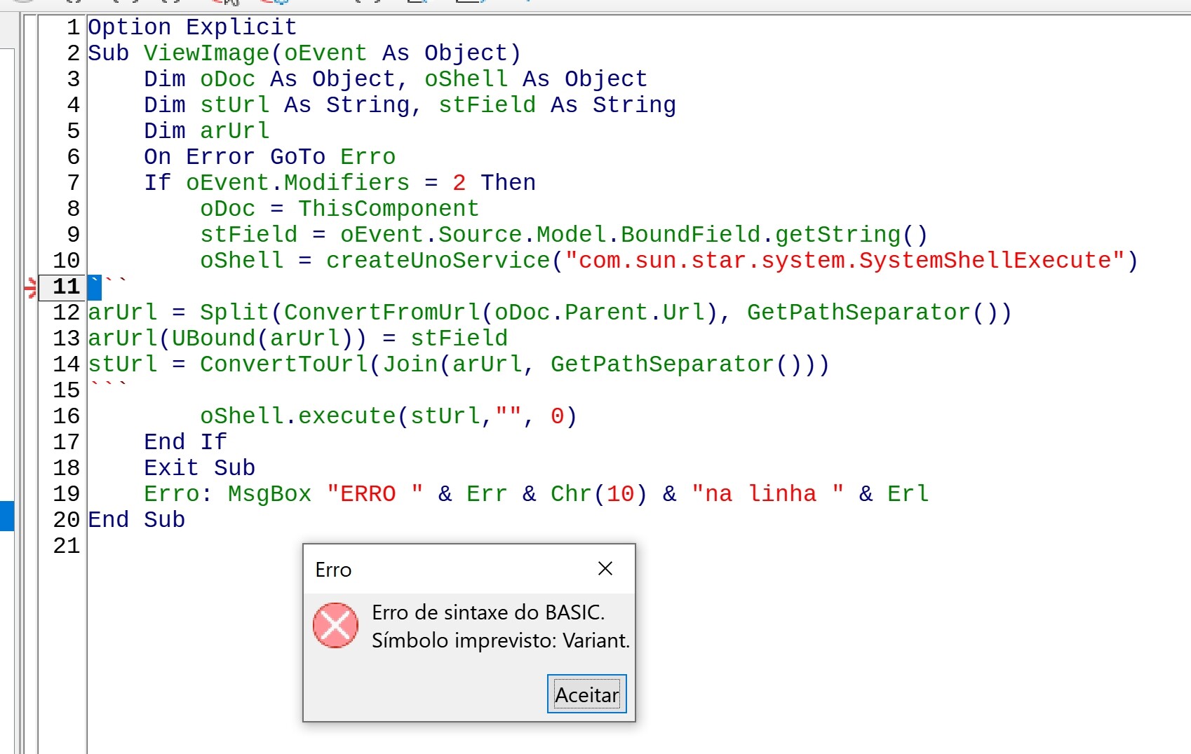

I´m sorry Carlos, where exactly should I put the three grave accents in the code? Before and after what? Thank you, and excuse my ignorance.! :cry:
The code, like
So the code gets formatted like code:

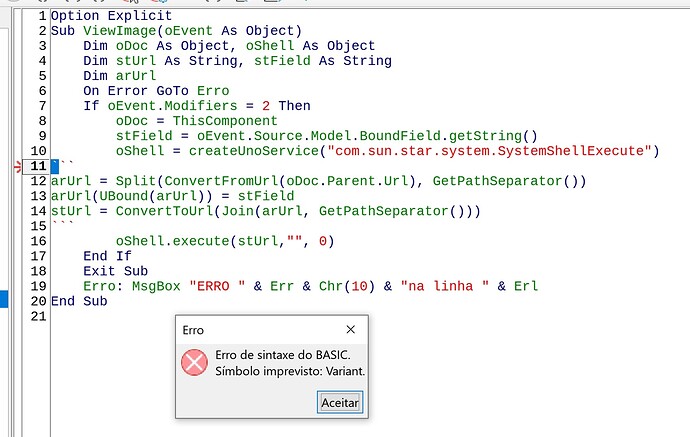

It’s funny, it keeps giving an error, now of a different nature. Could you tell me where I can read more about this to better understand this type of encoding preceded by 3 backticks? Thank you.
Misunderstanding :grimacing:
Backticks here in the messages to renderize :ok: the code text. Not in the macro itself.
I’m not with the same machine now, but will try to build an example using @sokol92’s code.
EDIT

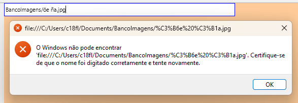

It didn’t work to me here. Named a photo as
and
NonASCII_name

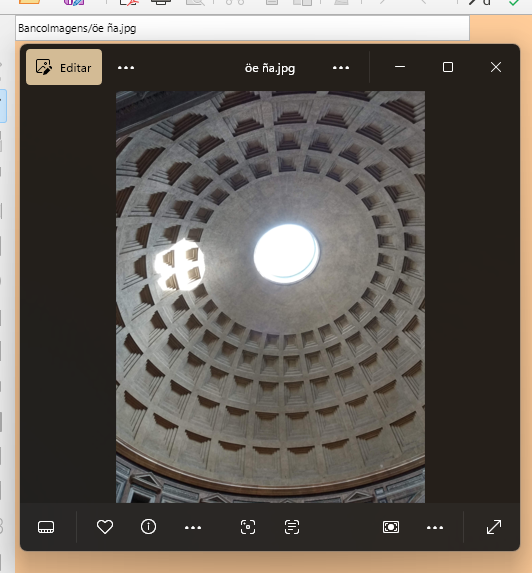

Hello!
Sorry, I didn’t notice how exactly stURL was used.
In this case, the filename is expected in the operating system format.
So try this:
stUrl = Join(arUrl, GetPathSeparator())
I just tested this part of the code for Windows – no error is thrown.
:clap: :clap: :clap:
Yes, as I can see a slash behind BancoImagens, while backslash is used for the first part. I guess mixing separators in one path is no good idea.
But there seems also to be active url-encoding for the filename.
Can’t test today, but I think for ShellExecute we need a regular path for the OS and may even need to use the same encoding as the shell itself. Utf8 can not be assumed valid for Windows.

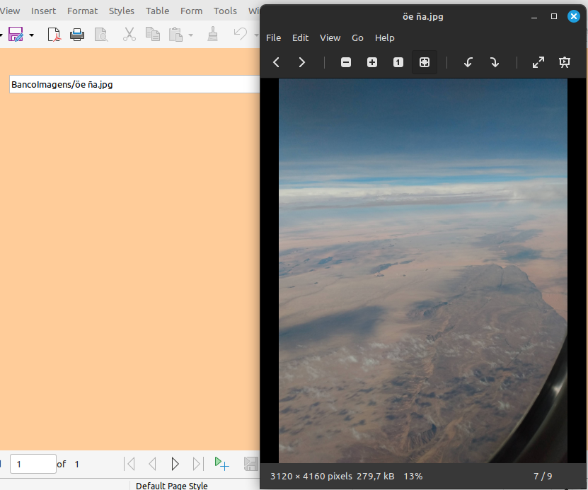

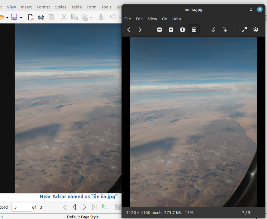

On Linux Mint 21.3 Cinnamon now

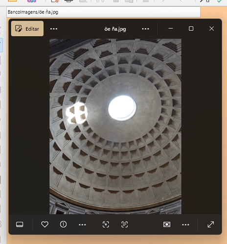

Made a copy of my photo “Adrar.jpg” as “öe ña.jpg” and “my” original code is working :ok: both in
  1. form with Image Control: Ctrlclick on the image;
  2. form (Table2) with TextBox for the Path string: Ctrlclick on the TextBox.
    :thinking:

  1. There are 2 kinds of forms:
    Imagens with an Image Control — as per OP. This is not working for non ASCII.
    Source = table IMAGENS.
    Paths only a TextBox with the path to image. This runs :ok:
    Source = table PATHS.
  2. Of course place the images in subfolder.
  3. Please take notice that for the Image Control Base % encodes non ASCII paths. I imagine :thinking: this is the issue on Windows.
    On Linux all works :ok: here.
    Of course I’m doing this in a W-11 machine now.
