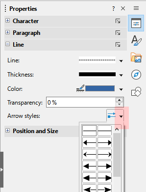

Properties is missing cap type. Graphics Styles > Lines affects other lines too.

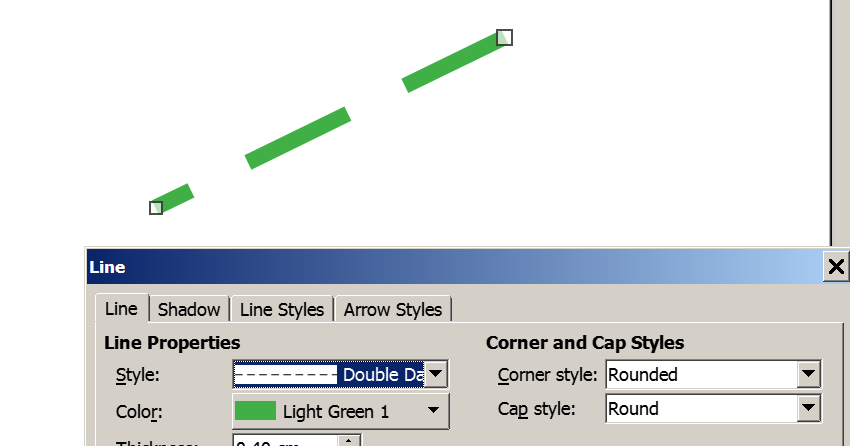

Cap is the “detailed” shape at the end of a thick line. Draw offers 3 possibilities:
- flat: the line ends abruptly at the exact end coordinate
- rounded: a disc is added, centred on the end with diameter equal to line thickness
- square: same with a square
The last two options cause the line to be visually longer then the mathematical distance between the end coordinates.
You can create a new style.
What’s imprecise? And there’s no slang.
Google: In LibreOffice Draw, a cap type refers to the shape of the end of a line or a dashed line, which you can change in the Line properties under Corner and Cap Styles . You can find this setting by right-clicking an object, selecting Edit Style , and navigating to the Line tab.

The Properties side pane does not show all properties of an object.
For a line, it is better to right-click after selection and choose Line.
