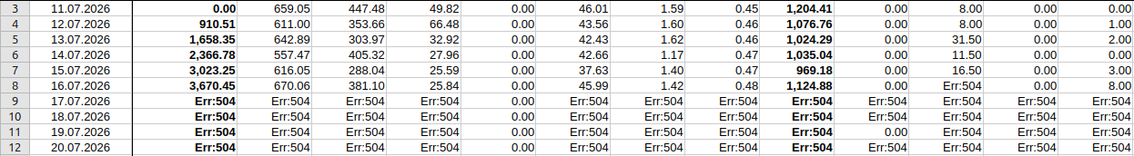

Because of the complexity of the file, the error persists even if I hit hard calculate. The formulas are ok.
The only way to resolve the issue temporarily is to rewrite the formula for any of the columns by double-clicking the bottom-right corner of the cell, but it works only for 1 row, which means i need to do it about 360 times every time i open the file.
I’m pretty sure the formulas are not wrong because the first few rows are ok by default.

This is when i open the file:
This is after i enter some data:

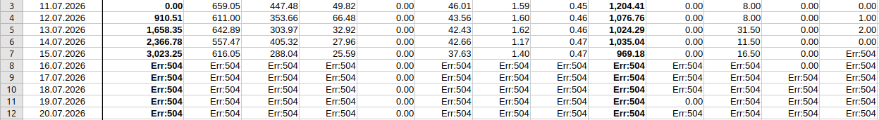

And this is after i rewrite some formula on a whole column by clicking on the right bottom corner of the cell. It solves the next row.

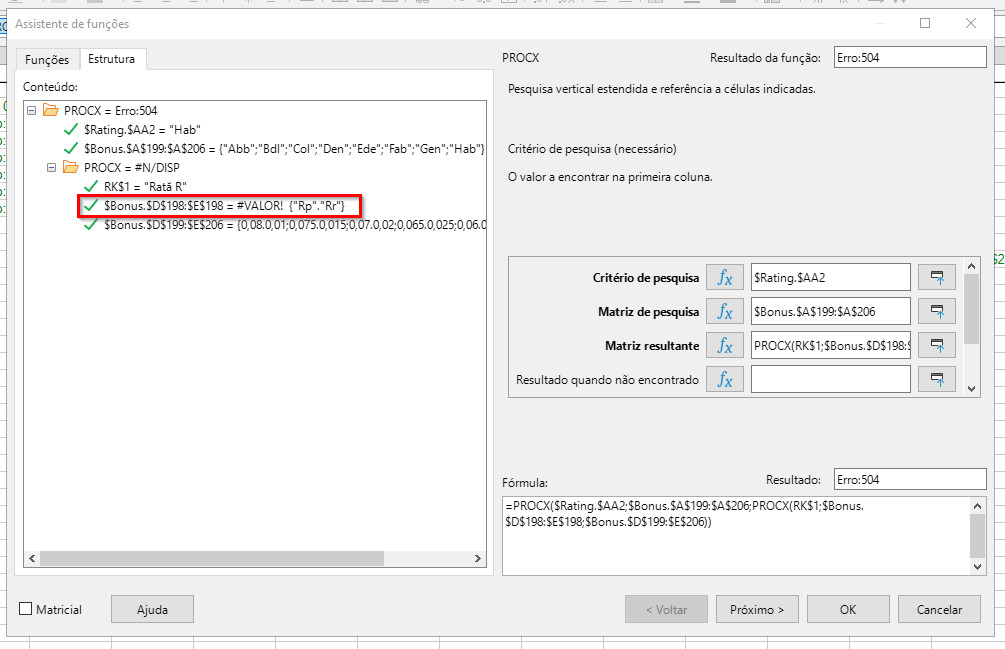

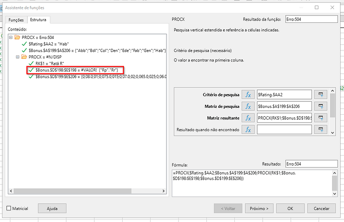

Hi @emy1, please review the formula in this cell AC.RK2
Select the cell, press F2, and activate the Function Wizard.

In $AC.RK2 (that is worksheet AC, cell RK2), the second (inner) XLOOKUP is incorrect. If the references and the syntax of that inner xlookup were to be correct, then that part of the formula should had been an array formula. Alternatively, the arguments for that function are inadequate. Whether that is the correction needed for this cell / column – I doubt it – I don’t really know, because I don’t know (nor care) what exactly you are trying to retrieve / achieve with that formula.
Whatever you are trying to achieve – please do not explain it – I would suggest for you to review all your xlookup functions, because they are involved in many of the initial errors that trigger chains of errors in your sample file.
Additionally, you seem to be using xlookup to search for labels, but they do not match – you are using different labels than what you are searching for – so errors are unavoidable even when the formulas and the data were to be correct (which anyway ATM they don’t seem to be).

In $AC.RK2 (and in RJ2, and who knows in how many other cells / columns), the second (or inner) xlookup uses a “Result array” argument that is a range ($Bonus.$D$199:$E$206), which means that either:
  • you are using the wrong function; or,
  • you are using wrong arguments; or,
  • the function needs to be an array formula.
Quoting from Help content:
If Result Array is a range of cells, the XLOOKUP function must be entered as an array formula.
Considering that the xlookup function in question is not located on a column by itself (as it is an inner function which takes its result as an argument for a second xlookup), my guess is that whatever you are trying to retrieve with that inner xlookup is not what you are really obtaining.
So, for row 2, you at least get some numeric result for the outer xlookup, which you see displayed on the cell ($AC.RK2). The first row (row 2) gets you “some” numeric result, despite having the “#VALUE!” error as result of the inner xlookup. But then, for the next rows, you actually get an error, because the outer xlookup doesn’t know what to do with the failing result from the inner xlookup.

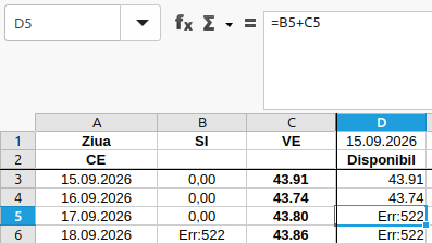

I still get one error on one of the sheets, namely 522, which makes no sense. A picture:
error 522
It’s just a simple sum, where both cells have a number, not an error.
If i apply the formula again for the whole column, the error disappears completely from the whole sheet.
