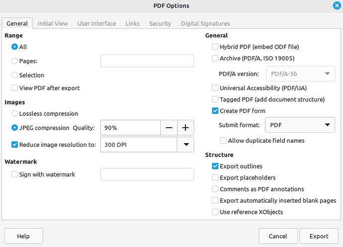

Uploaded a small sample file as .odt and .pdf as well as my “export settings”. After you set me thinking again I solved the second part of my problem. For a font of 6pt I need to set the text-box to a height of 0.37 cm or more. Then it displays ok. Thanks for that!
Remains the very small font when I type into the text-box, too small if I want to see much of an A4 form on the monitor.
Test_odt.odt (10.4 KB)
Test_pdf.pdf (9.8 KB)

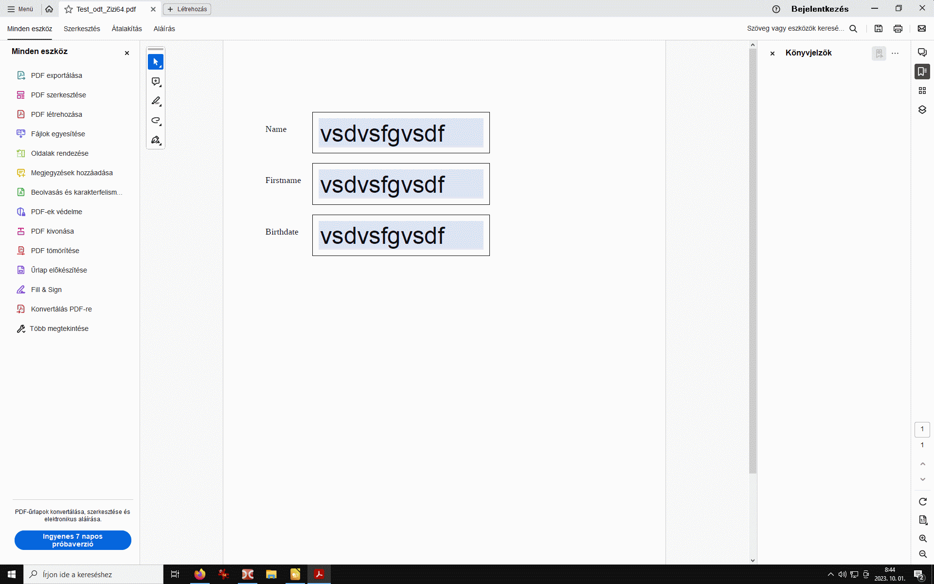

It works for me: when I use larger TextBox size AND a larger font size in the Writer, then the PDF export and the PDF reader software uses same (enlargened) sizes. See it in my attachments.
LO version: 7.5.7,
PDF reader: Acrobat Reader newest veresion (I do not know/ can not found the version number…)
Test_odt_Zizi64.pdf (10.0 KB)
Test_odt_Zizi64.odt (12.4 KB)
