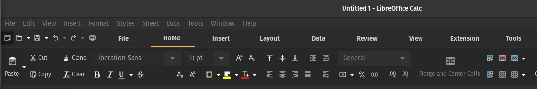

Hello,
I am using LibreOffice 7.2 with Tabbed UI on PopOS 21.04
In calc there is an extra toolbar
This is not the case with Writer and Impress
Any idea how to solve this.
Thanks
Hello,
Thanks
Hover over the leftmost icon just below the menubar. You will see a tooltip that says Menubar, click it and the menubar will disappear. Cheers, Al
Thank you.
