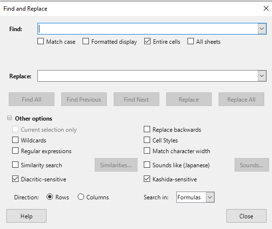

Usually, when I clicked the “Find and Replace” icon, the lower part of the dialog box with the “Other options” (search only in the current selection, regular expressions, etc.) was already open by default.
Since yesterday evening, this doesn’t happen anymore, I have to manuallu click the “+”

So, in Calc it seems that when I click “Find and Replace”, “Other options” is already opened if I have some cells already selected, otherwise not
In Writer, if I select text and then click “Find and Replace”, the selected text appears automatically in the “Find” box: this didn’t happen before.

I selected “Kashida-sensitive”, since I don’t have files in Japanese it shouldn’t impact at all my work whether it’s selected or not, while providing a solution to this problem
Leave at least one of these options marked: Wildcards, Regular expressions, Similarity search (I mark [x] Regular expressions).
EDIT (after @sokol92 comment).
Also stays open with any of:
[x] Cell styles
[x] Souds like (Japanese)
[x] Kashida-sensitive
The “Kashida-sensitive” option, which is set by default, helps me out. :slight_smile:
