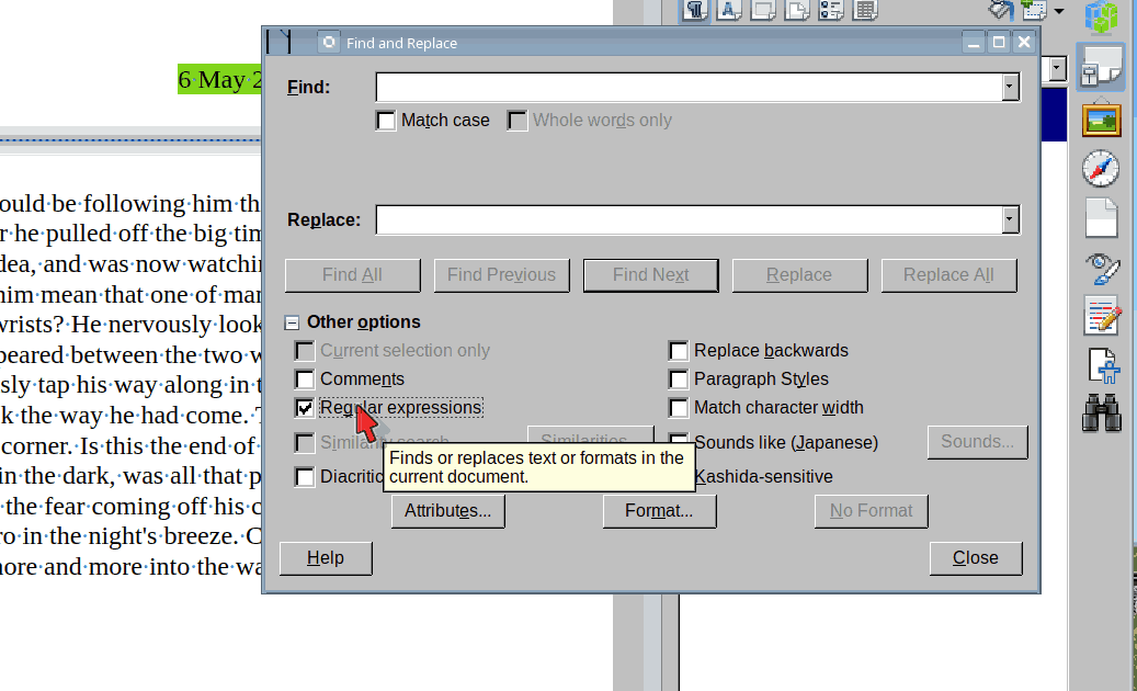

Depending on your install you may need to switch on regular expressions first. Newer installs seem to be set to simple pattern instead of regular expressions, as often users from Windows/MSO have never heard anything of regular expressions.

Did you remember to enable regular expressions in the F+R dialog?
Yep, the braces [ were for word, etc. I still will need something unique if that’s the case. But I will wait for that and try this new “altsearch” extension
OMG … OMG … wow, no! I didn’t see this, just tested and yes this changed those pesky tabs and spaces … this might be my game changer!! and maybe the ALTSEARCH will fix the paragraph commands
