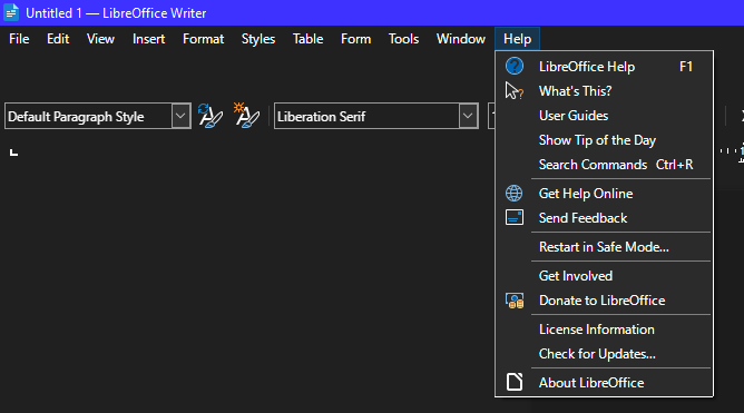

    Here’s an example:
    Two font-related commands added to the Help menu become available in the Search Commands feature.

There are no font commands in the Help menu. Are you telling me I should add commands to the Help menu so they appear in search? I did not find any way to do that.

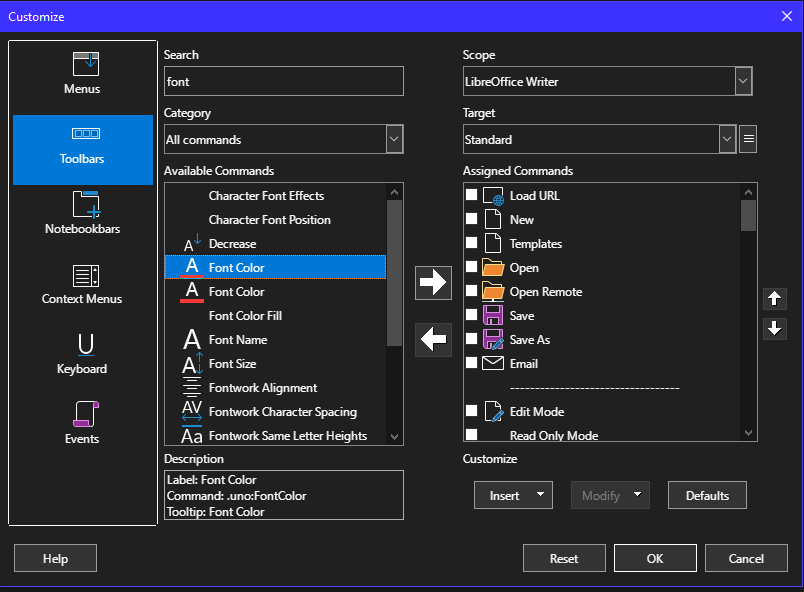

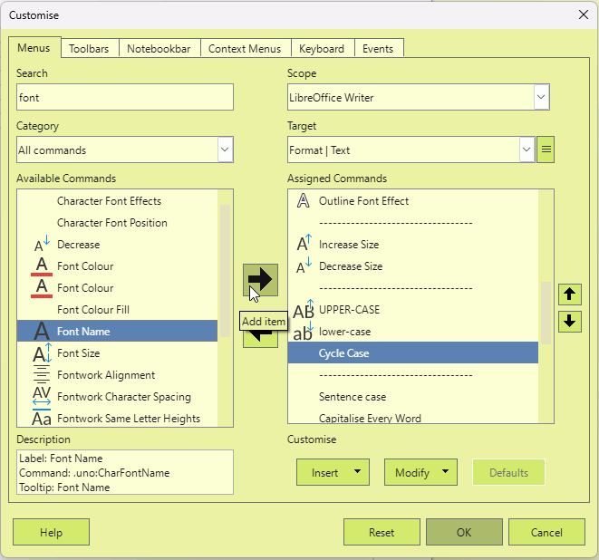

You can add commands to a relevant menu by clicking Tools > Customise > Menus. Select a relevant Target menu (or create a new menu), (optional) select an existing command below which you want to add the new command, in the Search field type font, select the appropriate command and click the right-facing arrow to add the command. OK
That worked. Thank you. It is odd that any commands would be obscured in the search. Is the purpose of the search not to allow access to everything without occupying screen space with many buttons?
