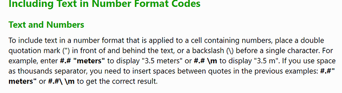

Hello all,
I have a column that I’d like to format to read grams as “gr” for every number I put in there (making a cook book in Calc). What’s the best way to go about this?
EX: B1 would be 50gr

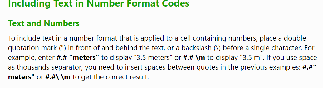

Hello all,
So for my use case, I’d click on B1 cell, type #.# “gr”, hit Enter, then go back to B1 and type in the value I’d like to give (i.e. 50 for 50 gr)?
No, you use #.#" gr" as a number format, Ctrl+1 or menu Format → Cells…, tab Numbers.
