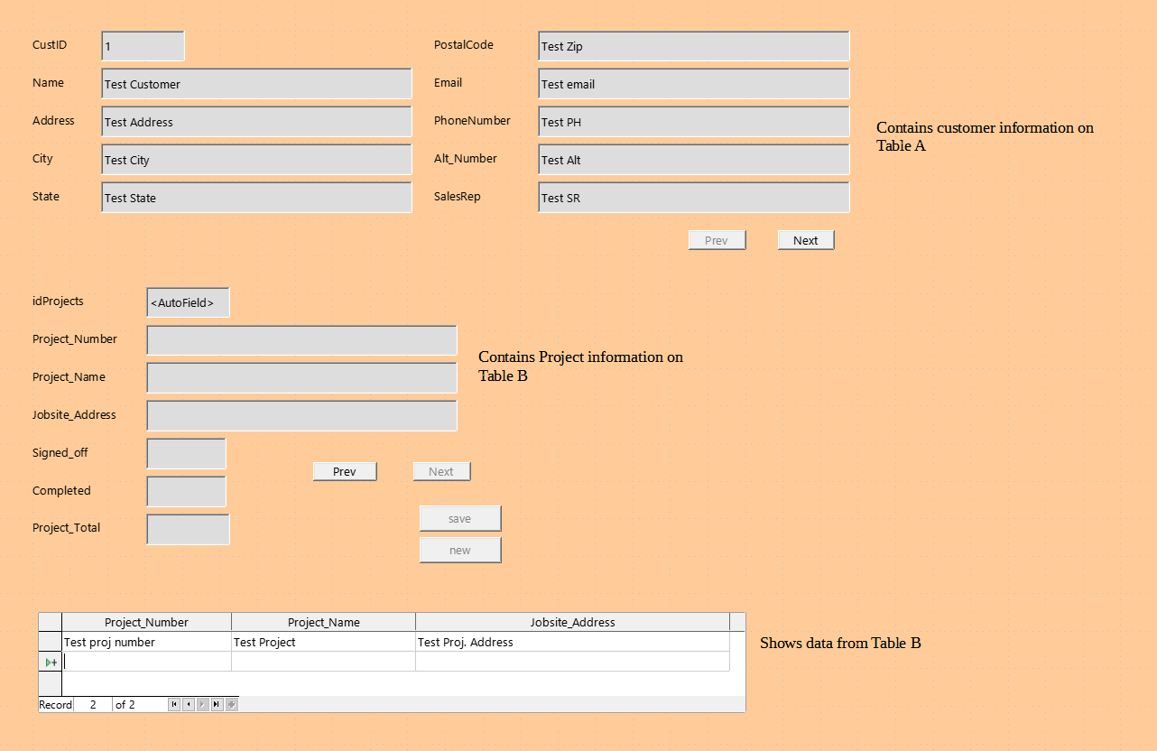

I have a writer form with a main form and a sub form.
The main form contains customer information.
The sub form contains project information and a table that reflects information entered in the subform.
One customer can have multiple projects is the basis of this form.

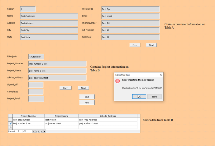

I have created the relations ships in the tables but I keep getting an error message about Duplicate Entry.

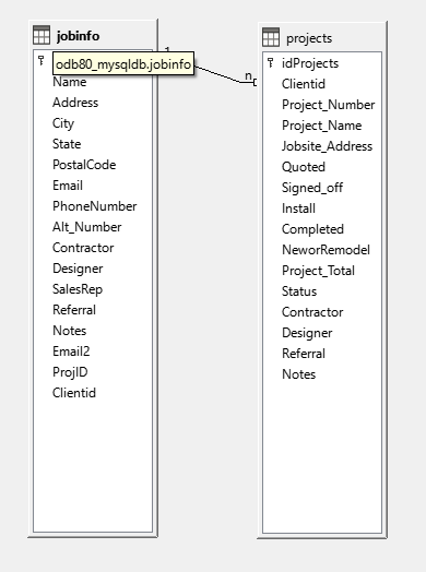

On Table job info the Client id is the primary key
On Table projects the id projects is the primary key
I created a 1 to many relationship between Client id on Job info and Client id on projects

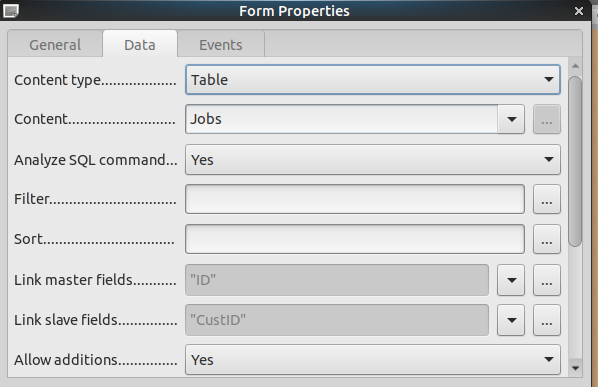

Hello,
Do not see Clientid on the sub form. Also the sub form needs to be linked to the main form:
Screenshot at 2022-07-22 09-07-51
Sub Form properties - master/slave links.
