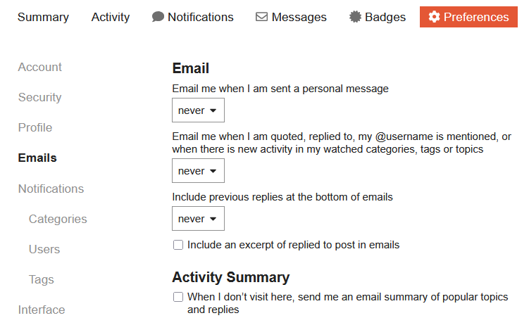

Last, is there a way I can prevent responses to this post being sent to my email. I receive html or other coding symbols mixed in with the message. It’s garbled, and for all practical purposes, unreadable text.

response to LeroyG
Thank you very much for providing the undesired email solution. I’m just now beginning with the AskLibreOffice web pages. I think it would have been a long time, if ever, for me to find the information!

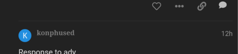

A question about Ask LibreOffice: Is there a way to display the dates a post was made?

Instead of the date, the site shows how long ago the post was written:
April 30 2026

Thank you for disclosing how the time or date a post was made. The number of days or hours passed are difficult to see. I don’t know why the days or hours passed and other symbols on the web page are so light. I have to open the curtain just right and make sure I’m directly in front of the screen to discern the light text and symbols. Personally, I’d like BLACK text and symbols.
