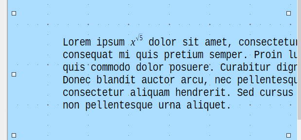

I mean that the formula should be rendered as a part of the text:
…some text… formula … text continues…
Here is a demonstration what I mean:
formula-test.odp (28.2 KB)
I had to insert spaces to the text box and place the formula into the empty space. Has anyone considered implementing formulas in text in Impress to behave as in Writer?

Thank you! Now it is clear what you want to do.
My observations:
  • It appears that embedding non-character objects “as character” into a text flow is indeed only available in Writer.
  • If you create the content in Writer, copy that and paste into Impress, the pasted object is an embedded Writer document, which makes it rather cumbersome to work with.
  • Also, sometimes the formula seems to be thrown off vertical alignment (“jagged baseline”) when Impress renders the writer document object.
Whether anyone on the developer side considered “streamlining” this behavior for text objects in other apps, I do not know. The issue tracker is the place for introducing such ideas for consideration. The problem you describe was already registered as a request 15 years ago in case #35033.
For the time being, it appears that your approach as demonstrated - manuallly insert space into the text to accomodate the formula object - is the optimal solution available.
The Writer object approach may also work if you set the Writer document to a small page size and zero margins. The “baseline drop” I mentioned only occurred rarely when I tested, so it may be something to do with my graphics hardware/drivers.
Take care of “drag mode” when working with embedded objects though, or you may distort the rendering (stretch/skew).
