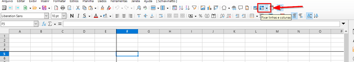

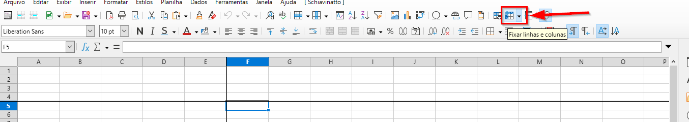

Select cell F5, click the “Freeze rows and columns” icon…
That’s in the Calc help and guide since version 24.2
In my LibreOffice installation (26.8) I have tested it and it works correctly and without problems.
You may have an old version of LibreOffice or other problems (may be a corrupt user profile)

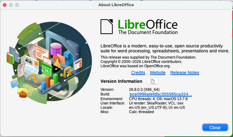

No I have version 26.8.0.3 and it only does either a row or a column.

Your system is a Mac, there may be differences with mine, Windows.

  • Select cell F5
  • Menu View > Freeze Rows and Columns releases the frozen row
  • A gain in the menu View > Freeze Rows and Columns will freeze the rows above the 5th row and the columns to the left of F colunm
(At least that’s what I can do on my system).
The fact that 'm using a Mac could be the difference, but it doesn’t makes sense that the developer of LibreOffice couldn’t figure out a way to get it to work like on Windows.
