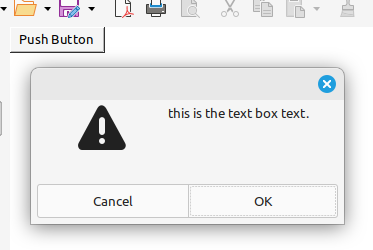

Another form = FCaller
Opened Form with the textbox TextBox1 = FTextBox > Main
Option Explicit
Sub LerTB(Evt As Object)
	Dim Frames As Object, F As Object, FMain As Object
	Dim chk_forms As String
	Dim i As Integer
	On Error GoTo Erro
	REM CHECK TARGET FORM IS OPEN
	Frames = ThisDatabaseDocument.getCurrentController().getFrame().getFrames()
	For i = 0 To Frames.count - 1
		F = Frames.getByIndex(i)
		chk_forms = Mid(F.title, Instr(F.title, ":") + 2)
		chk_forms = Trim(Left(chk_forms, Instr(chk_forms, " - Libre")))
		If chk_forms = "FTextBox" Then Exit For
	Next i
	If chk_forms <> "FTextBox" Then Exit Sub
	REM IT IS OPEN:
	F = ThisDatabaseDocument.FormDocuments.getByName(chk_forms)
	FMain = F.getComponent().getDrawPage().getForms().getByIndex(0)
	print FMain.TextBox1.Text
	Exit Sub
	Erro: MsgBox "ERRO " & Err & Chr(10) & "na linha " & Erl
End Sub
