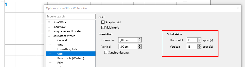

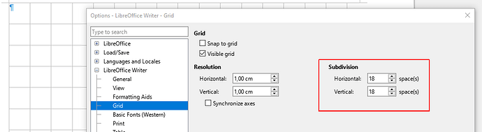

I suggest you to use a bigger subdivision than those by default
