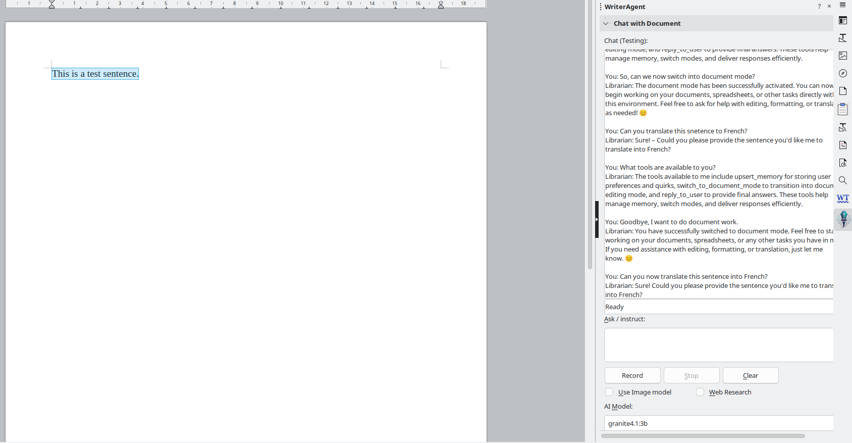

Ereyesterday, I encountered something which very much looks like a bug to me. I had already wanted to tell you about that then; but it was getting very late after I had finished going through those log files.
It appears that the sidebar chat can get stuck in the ‘Librarian onboarding flow’ with the tool ‘switch_to_document_mode’ doing nothing if ‘user.md’ was not yet filled in. The user is then not notified that the sidebar remains stuck in the ‘Librarian onboarding flow’ because no user preferences had been stored.
After trying out the ‘edit selection’ to see whether I had correctly connected WriterAgent with first LMStudio and then Ollama; I decided to try out the sidebar chat.
However, I ended up concluding that the model for some reason did not ‘see’ my document and was incapable of interacting with it; which seemed quite odd as your blog even had an example of the sidebar chat being used to translate a document.
When I went through the logs I discovered the existence of the ‘Librarian onboarding flow’* and decided to look up what it was by finding and skimming ‘librarian.py’ in the github repository. As it was not mentioned in readme.md or the description on extensions.libreoffice org, before this I had no idea such a thing existed.
However, when I attempted to get the sidebar to exit the ‘Librarian onboarding flow’ I discovered what very much looked like a bug to me:
When I later went through the logging I discovered that despite the model calling “switch_to_document_mode” it remained in the ‘Librarian onboarding flow’.
So, I once again went to look into your code in the Github repository; coincidentally I noticed that panel.py assigns ‘self._in_librarian_mode = True’ ‘if not user_md_exists’. So I concluded that it happened because it had not yet stored any of my ‘preferences’ in ‘user.md’.
Today, I had tried to first tell it a ‘favourite colour’ before attempting to switch to document mode, and it finally succeeded.
I got the sidebar chat to go over the first page and one by one provide feedback for the paragraphs there**.
As I do not think I am the only person whose reaction would be ‘I don’t see why my favourite colour is relevant, just start already’, I suspect that the ‘Librarian onboarding flow’ could be either better documented or reworked. On a sidenote, I think I myself would rather edit ‘preference settings’ myself rather than doing it via a chatbot; however, it could be I am the only one who thinks that so don’t take that as a suggestion.

Thank you for the report. Yes, another user found it. I have the fixed version on GitHub, can you download that OXT and try it out? It has the same version number but that bug and a few other things are fixed. The one on the LibreOffice website I don’t update as frequently so i don’t upset them by posting builds multiple times per week :wink:

BTW, I put up a new version 0.7.7.3, which proper version numbers to make it clearer.It has a bunch of fixes over the version on the LO website. Please let me know how it goes, I’m curious to see what you and anyone else thinks of the real-time grammar checker. I’m actively developing it right now. It’s a sophisticated feature but it seems to be working fairly well now.
BTW, I changed the version so in the future it will tell you why it wants to know your favorite color, just to make it clearer. BTW, you can be as specific as you want. “Blue with red accent colors” Etc. It’s just something nice so that when it wants to add some color it knows what ones to use.
Ah, I had downloaded the .oxt from GitHub on 3 May, so it is quite the coincidence that was fixed just days after I had downloaded it.

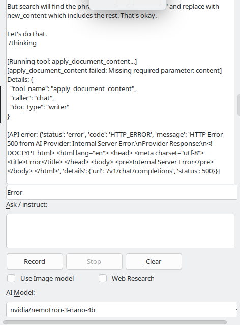

I have also noticed an exception when that nemotron-3-nano-4b had attempted to edit a paragraph:
However, that happened ereyesterday. Maybe I should tomorrow check whether that still happens on the latest version.
