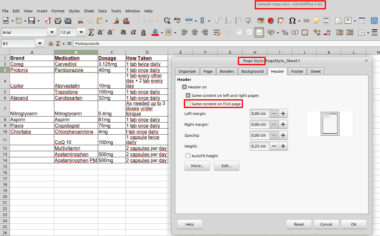

I am using LO 7.4.7.2. I need for the Header to print with my selected page, but it is not doing that. There does not appear to be a choice under Format for Page (or I’m just plain missing it). Have searched but no success at finding an accessible answer. View is set to normal and Header is a custom entry.

Thank you for such a quick reply. Unfortunately, that does not answer how to get the Header to print. I had already set up the Header for the middle position, but no where I can I find a place where you can make it print. A search of Help says View must be “normal” which it is, but Page Preview does not show it.

It would be great if you upload your file and we’ll see what’s going on together.
Here is the file:
Sample copy.xlsx (5.6 KB)
Appreciate the help!
Select First Page
Then alter some values for spacing etc.

In addition to the previous answer:
Increase the value of the Height property or use Autofit height.
Thanks Grantler. That did the trick!
